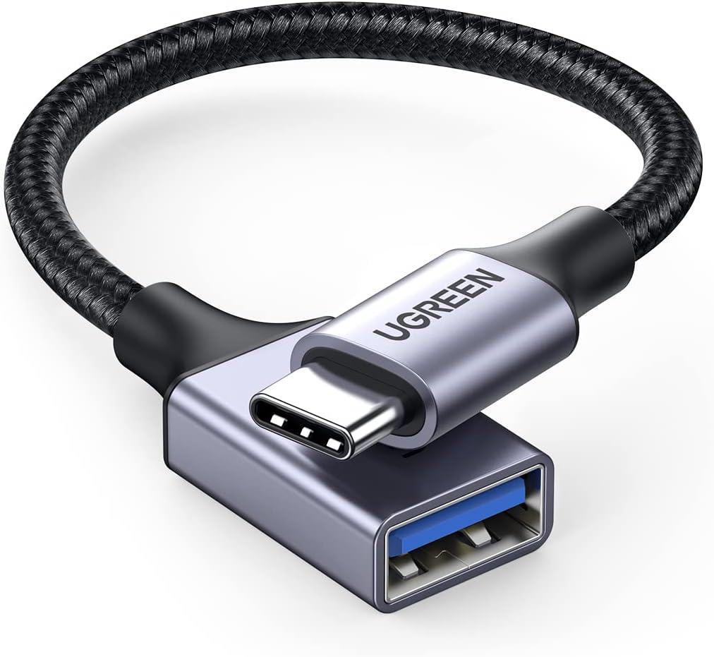

I recently purchased a UGreen USB-C to USB-A socket (so-called OTG adapter - see attached image) so that I can connect an external audio interface to my FP4 and record audio directly from an external source while recording video. Specifically, I want to video myself playing instruments in my small home studio and record the output from my mixer/DAW rather than using the internal mic on the FP4. While audio does indeed record along with the video footage, the quality is very much lower than I had hoped. It sounds muffled, almost as if there’s a low pass filter cutting all frequencies above approximately 10-12kHz.

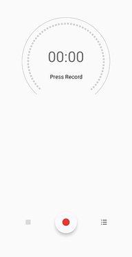

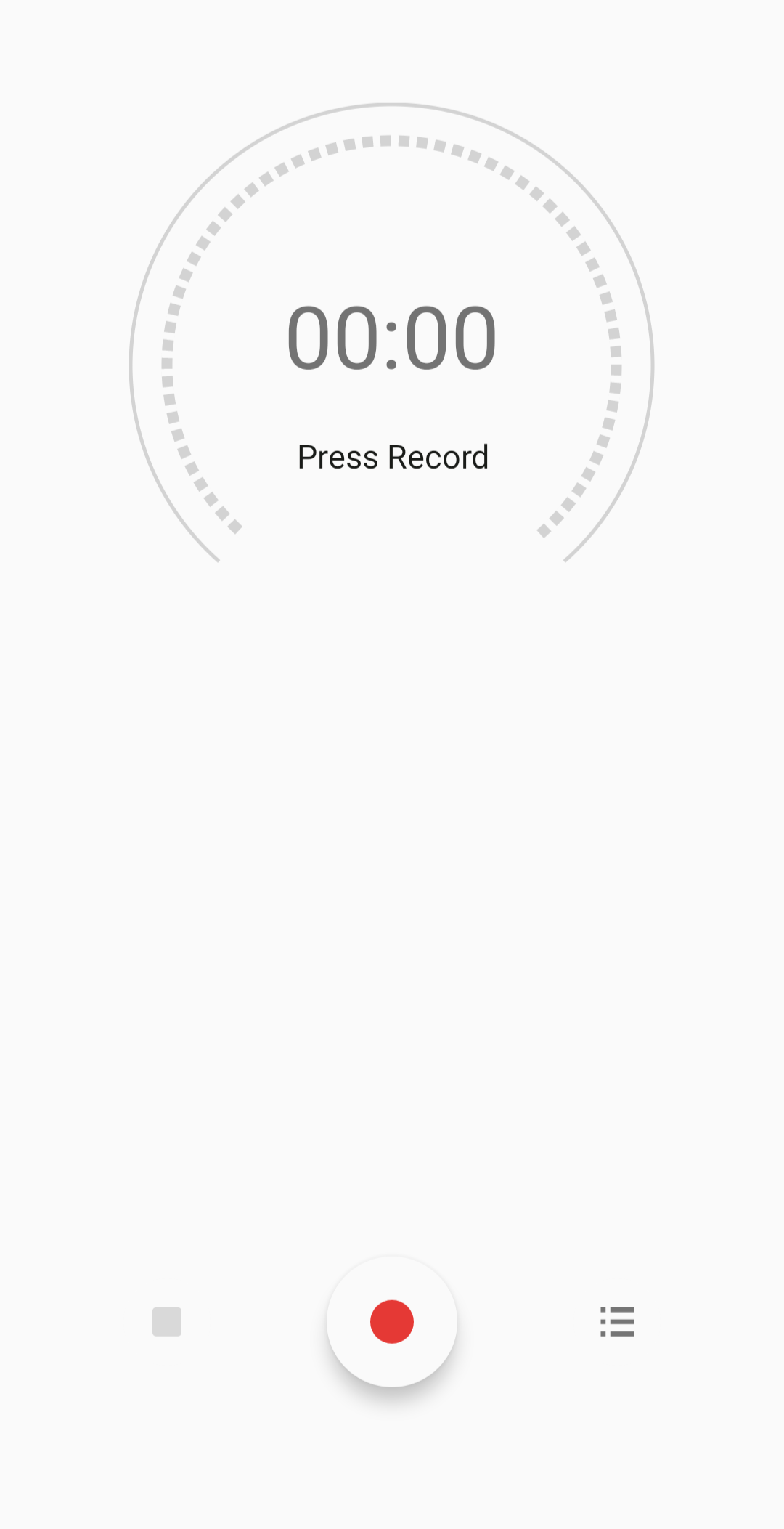

Thanks for your reply. Unfortunately, the Sound Recorder app has no way for me to specify audio quality or audio input source. The version I have installed on my FP4 is super basic and only features a record button, a stop button and a menu for accessing previous recordings. I have a third party app called Audio Recorder which allows me to specify the audio file format I wish to record to (i.e., various bit/sample rates of M4a, Wav and 3gp) but again, it has no way to specify the audio input source so I assume it just defaults to the FP4 internal mic.

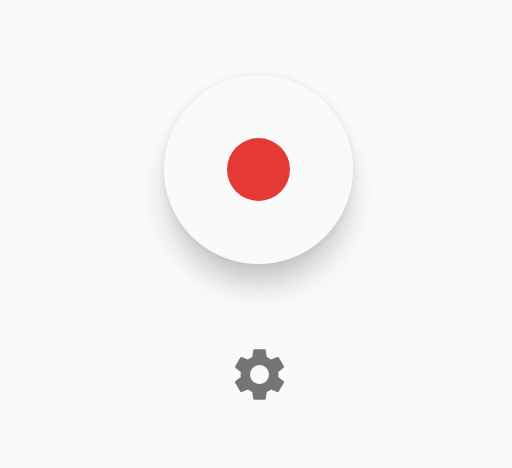

You don’t have the cog wheel button under the record button? That’s where quality is configured.

Also, your problem seems to be that you want to use an app that’s not designed for recording hifi audio to do exactly that (the camera app). Camera apps usually apply lots of postprocessing like wind removal etc and that is most probably the reason why your recordings are distorted.

This is the entirety of the app for me, there’s certainly no cogwheel to configure settings etc.
