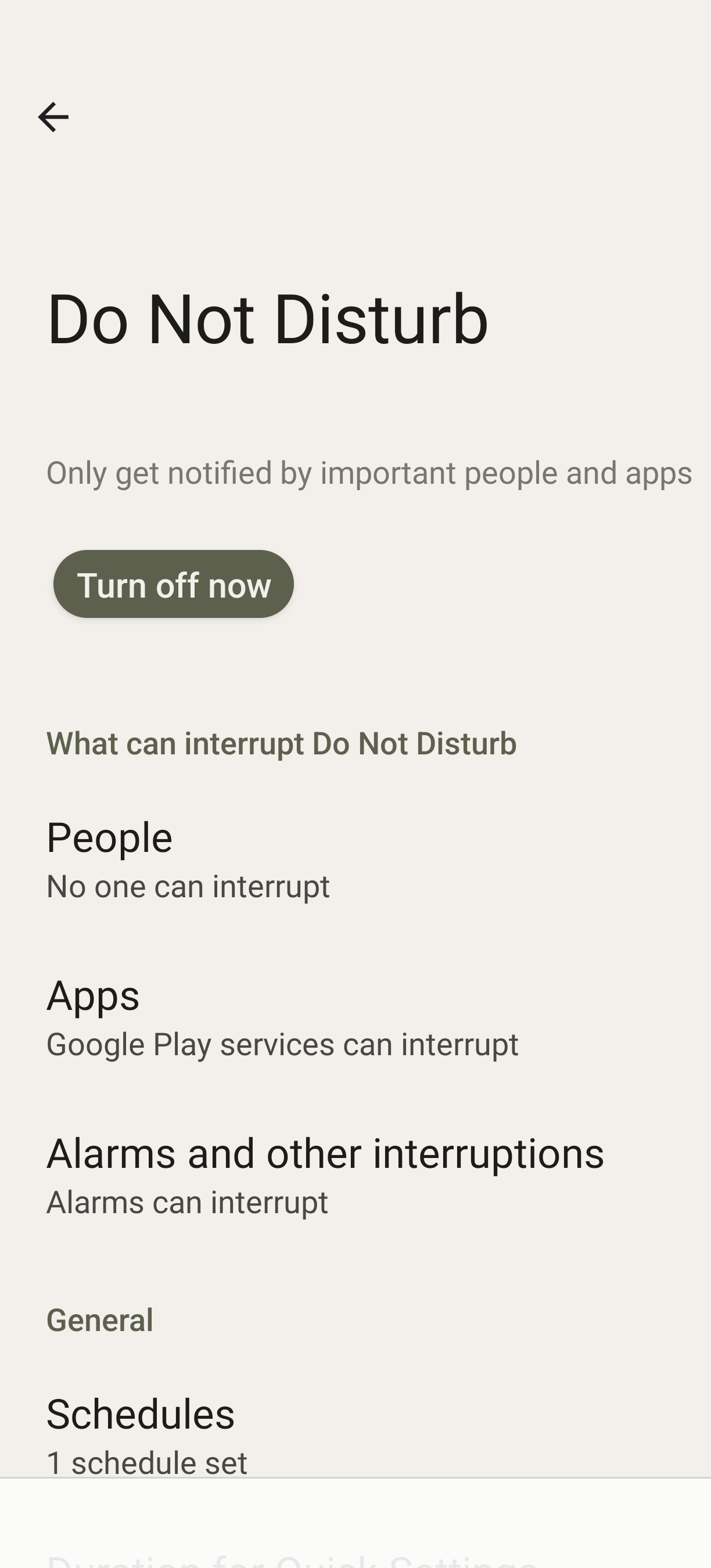

I believe it might depend on your DnD settings.
Thatâs my usual way of muting the phone so it does silence all the multimedia. Then I can easily reproduce, yes, once DnD is on, Spotify is muted and the volume option is off.
However I can easily modify DnD settings to play multimedia
I can also confirm this, I set DnD so even if I would accidentally increase volume overnight I wonât wake up my wife I open a video with music or just messaging app sounds. Line greyed out with a block sign
