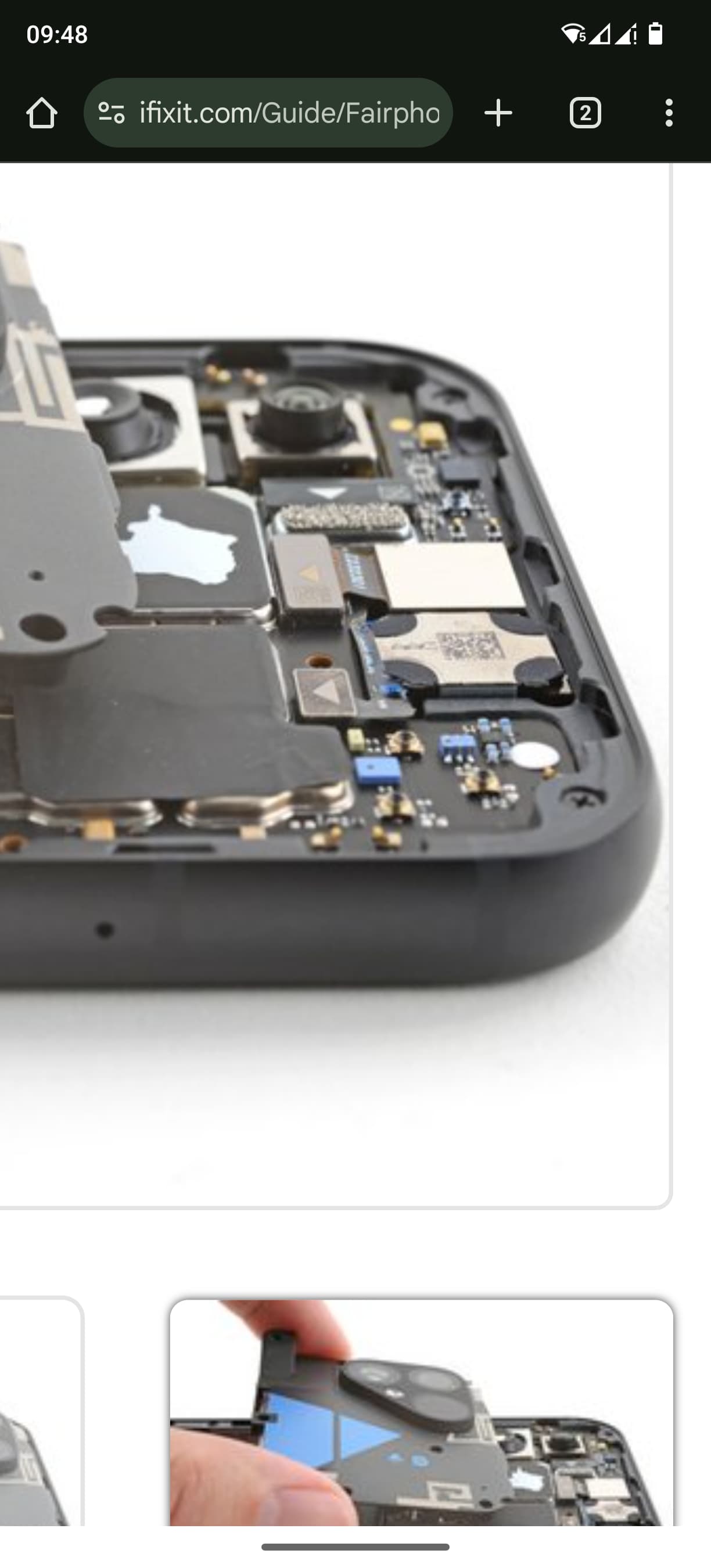

I’m not 100% convinced but it looks like the is one on the top of the motherboard right side looking from the back of the FP5.
and so far i did’t spot one more. but there must be at least a second one i believe.

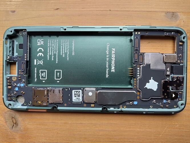

I happened to take a few Fairphone :four: shots the other day (actually just to upgrade our meetup announcement picture), but took the opportunity to lift the “forbidden” core module shield off the FP4. You can figure out a suspect easily, although I am not 100 % sure.
A second Fairphone :five: suspect:
I guess the assumption is close by that this is where the FP4 might have got another LCI as well. However, I already checked and the FP4 does not have an LCI in the battery tray.

I merged my two replies here. Actually I don’t know if I could clarifiy it any further, the first photo has FP4 written above it, the second photo FP5. The final comment simply says that unlike the FP5 battery tray (photo 2), the FP4 battery tray does not seem to have an LCI.
For the FP5 from schematics
