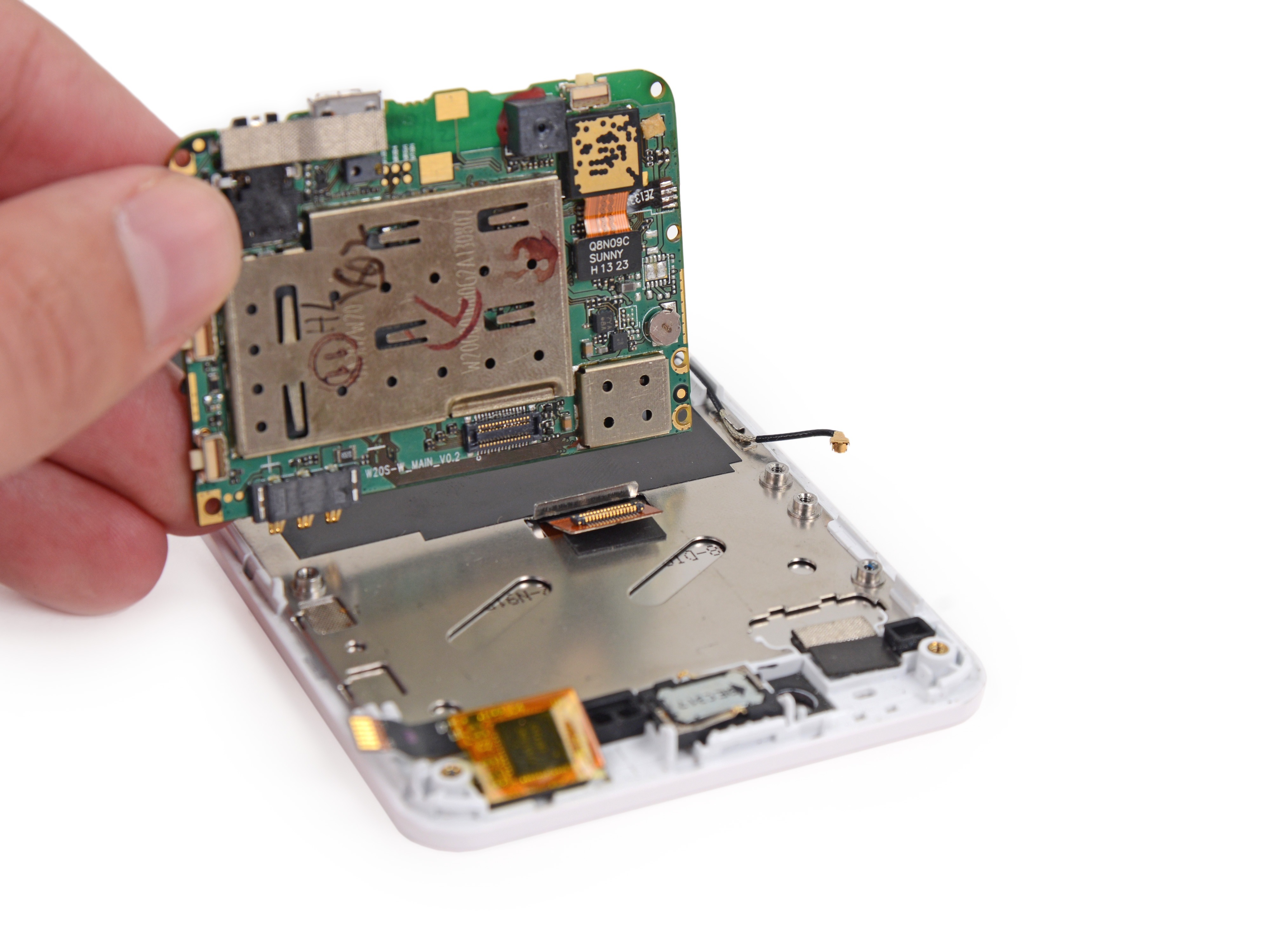

It reminds me a little bit of a broken power button (that is the “internal” power button on the mother board, not the power button you can see on the FP1’s outside). But I would rather encourage others to chime in here to offer better ideas.

Yep, I’d also say it’s a broken power button. A #localrepairshop could repair it for you. Basically they only need to solder in a new button for under 2€ (+time costs).

That would be a shame. You should tell them that there are repair guides available:
They only need to have a soldering iron with a fine point.
OK now the trouble starts - I have borrowed a soldering iron and I am beginning preparations. I’ve never used a soldering iron and only taken the phone apart once. But still, what’s the worst thing that can happen, the phone is dead at the moment, whatever I do to it isn’t going to make it any more dead!
Good luck! Be very careful, though. Do you already have a new button at hand?
Hi Stefan, yes I’ll be careful, and I don’t have the button yet - I won’t start until I do have one.

OK It didn’t work, it was optimistic at best so now I have some spares available… iPhone here I come :disappointed:

What exactly did not work? Did you try the soldering and did not succeed?
Yes Stephan - I tried the soldering and didn’t succeed so I think I have exhausted my options - neither of the mobile phone ‘repair’ shops in Bath will look at the phone because they have never heard of fairphone. Disappointing…
That is disappointing. The best you can do now is offer your motherboard in the #market:offered in case that someone wants to try the repair themselves or take it to a repair shop that is not lazy and/or full of cowards.
