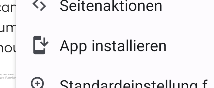

Yes, exactly, there is a difference.
“Zum Startbildschirm hinzufĂŒgen” is also there for me but it’s only a shortcut to open the page in the browser (,e.g. Vivaldi).
“App installieren” would install it as PWA independently. And it’s there for other pages e.g. when I open the Discourse or Murena forum etc.
And when I switch Vivaldi to English language it shows “Install app” on pages where it works and “Add to Home screen” where it doesn’t.

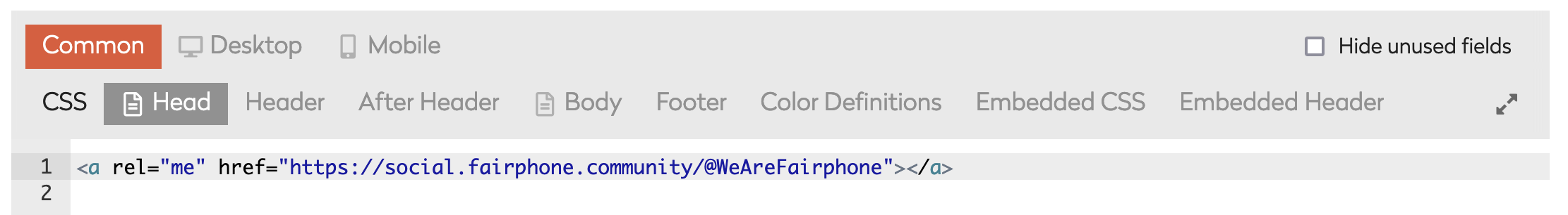

A few weeks ago I added this Mastodon verification link:
Strictly speaking an <a> tag is not allowed in the head section. As confirmed in various topics on meta.discourse.org this breaks the ability to save the site as PWA.
I’ve tested this on our sandbox instance and can confirm that adding the Mastodon link disables the PWA feature.
EDIT: it was suggested on meta.discourse.org to move the Mastodon verification link to the site’s footer. @paulakreuzer After making this change I would like to hear from you if the verification is still valid on your end. Let me know when that’s convenient for you.

I haven’t changed it yet because I don’t want to break anything on the Mastodon side. I’ll make the change once @paulakreuzer is available. Or maybe @urs_lesse can assist?

I have now made the change. This means that the site can now be saved as PWA. :smiley:
I did notice that the Mastodon verification link is still somewhat visible in the HTML code but I’m not sure if that’s good enough for Mastodon. I’m sure one of you will let me know if verification is now broken. :crossed_fingers:
I have actually followed this topic silently (until today), yet I did try if the “Install App” option was provided to me in the /e/OS default browser yesterday – it didn’t appear then. I have now tried again and it’s there! :+1:

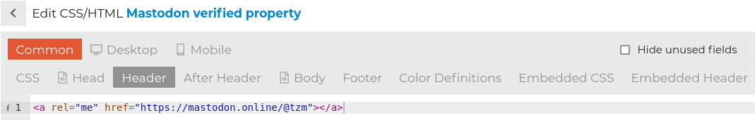

Try moving it to the “header” section instead of “head”. My Mastodon is verified and I can still install it as a PWA.
I can’t really say when/how often the Mastodon link verification is checked. Maybe wait a couple of days and check if it’s still there (it was a minute ago).
Initially I moved it from head to footer but that caused the URL to appear in an unexpected section of the HTML code and it was encoded in such a manner that Mastodon wouldn’t be able to read it.
Now I moved it from footer to header and all looks good. :slight_smile:
