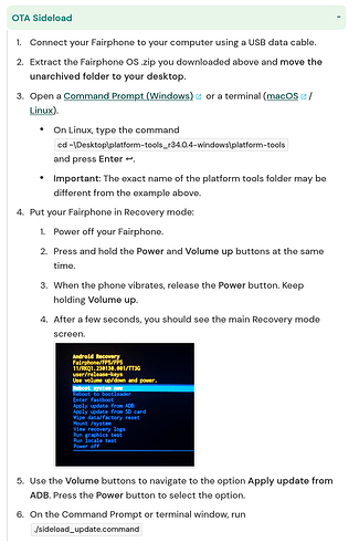

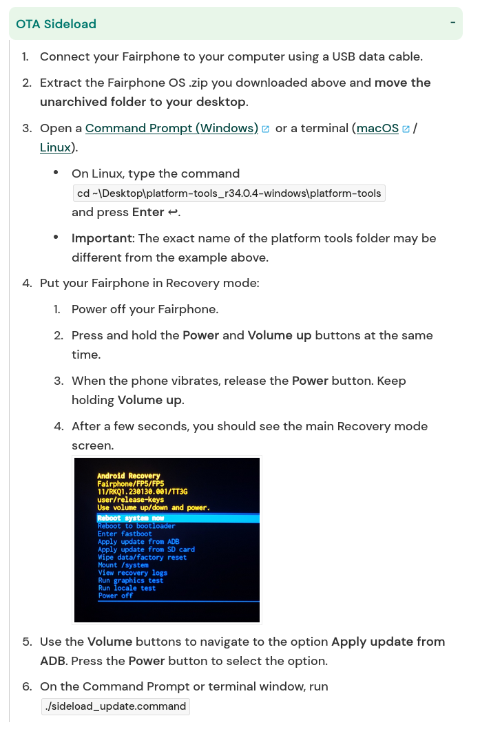

Hi, does the phone not turn on at all or does it just not boot into the installed OS (Android)?
Can you boot into recovery mode? (Step 4 in the picture)
Image source: https://support.fairphone.com/hc/en-us/articles/18896094650513-How-to-manually-install-Android-on-your-Fairphone
