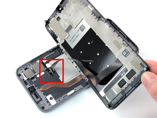

No reply has been marked as a solution yet. Is there any? Some people mentioned reseating the screen helped, but I suppose that’s then a temporary fix?
A never mind.
For me helped the solution of @twoexem to put some foam ontop of the connector to increase pressure.
No ghost inputs since a week, after daily horror…

I’m not an electronics engineer but I’m puzzled why a friction fit connector and a piece of foam was chosen to attach a display cable that needs sit perfectly tight all the time. I’ve seen all kinds of clamping mechanisms e.g. when repairing other electronics, but I’ll humbly assume there must’ve been a reason for this design decision.

My device is degrading rapidly by now. About 1 year old, countless re-connects of the display since month 3, until that stopped working. Inserted additional spacer as people here figured out, too. First spongy plastics, stopped working a few happy months later. Thicker stuff, another 2 months. Again thicker, taking the pressure points that came along with it on the display. One week. Finally received the foam pads mentioned in this topic, put them in, stacked 3 by now. Won’t help. Helped for one day, if that.
Be careful with what you stuff in there. I think it’ll make it worse after you remove it, and you’ll have to constantly up it. Which obviously has an upper limit.
So, insert just as thin a thing - like the foam pads - that you can get away with to prolong the usability.
I’ve opened this thing up so many, countless times (mostly just reconnecting the display), that the back cover is snapping at the edges, where the clamp points are.

I reseated my screen a week ago. I haven’t seen ghost touches anymore. But mine didn’t happen frequent and I also couldn’t reproduce it consistently since the cause is unknown.

I’m assuming my display was replaced because it had a brand new screen protector on it when I got it back. I see no reason why they’d replace that for this repair if the display module was still the same.
Additionally they definitely did something more than reseat because reseating the connector myself never solved the problem for longer than a few weeks.
