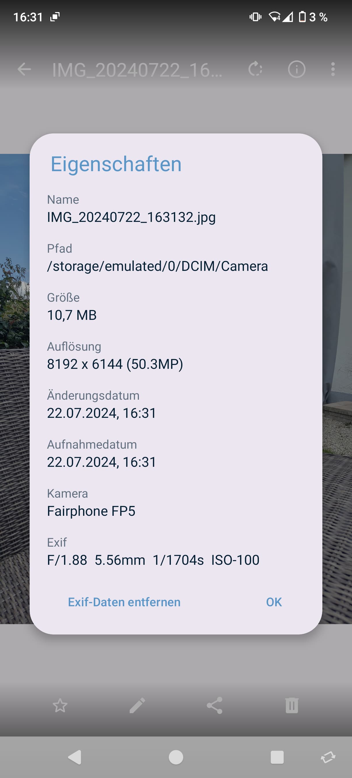

Is there actually a 50Mpix output from the camera module? I was under the impression that not and that the camera is logically a 12Mpix system.

I was under the impression that the FP5 module used pixelbinning and that the hardware resolution was not outputted from the module at all.

Yes if you want you can change to full resolution, normal mode uses pixel binning
