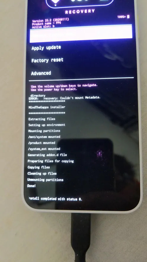

I just bought a Fairphone 6 and wanted to work with LineageOS. But unfortunately I need some of the google Apps. And I now ran too into the Problem that they don’t appear after flashing MindTheGapps.
Is there anything I can do/help to get that fixed?
You need to install 23.0, not 23.2, 23.0 is the latest one that MindTheGapps works with at the moment. And unfortunately you’ll have to skip updates until that changes.
You’ll need to install it from scratch, wiping your data and also flashing the 23.0 recovery, as the 23.2 recovery won’t let you sideload 23.0. I had the exact same issue and solved it this way (read above).
BTW @ArianK16a, I am a bit confused as to why MTG could break, I thought that if a version of it worked on a major release like 23.0, a minor release like 23.1 & 23.2 wouldn’t break it. Is there a chance compatibility will be restored and we who have MTG installed will be able to update LOS? Would that require changes on the LOS side or the MTG side?
I know you said you don’t work on MTG so I’m asking for a best guess, no need for a really detailed answer.
Maybe someone with more android knowledge than me can read something usefull out of this.
logs
[    5.251984] ro.virtual_ab.enabled=true
[    5.252108] ro.crypto.metadata_init_delete_all_keys.enabled=true
[    5.252402] wifi.aware.interface=wifi-aware0

[    5.265567] I:Clearing BCB
[    8.549216] I:Writing BCB boot-recovery recovery
[    8.549227] --reason=update_in_progress
[    8.549229]
[   10.761880]
[   10.761901]
[   10.761904] Now send the package you want to apply
[   10.761907] to the device with "adb sideload <filename>"...
[   10.785880] 01-02 00:03:04.464   452   453 I minadbd : usb_ffs.cpp:275 opening control endpoint /dev/usb-ffs/adb/ep0
[   13.393181] 01-02 00:03:07.071   452   452 I minadbd : adb.cpp:426 authentication not required
[   42.804441] 01-02 00:03:36.483   452   460 I minadbd : minadbd_services.cpp:111 sideload-host file size 511284025, block size 65536
[   43.804963] unknown fuse request opcode 2016
[   43.821121] I:current maximum temperature: 61618
[   43.821147] Supported API: 3
[   43.829706] Finding update package...
[   43.838040] I:Update package id: /sideload/package.zip
[   43.863371] I:1 key(s) loaded from /system/etc/security/otacerts.zip
[   43.863398] Verifying update package...
[   43.873969] I:comment is 1602 bytes; signature is 1584 bytes from end
[   52.924558] scudo: Can't populate more pages for size class 65552.
[   52.924578]
[   61.327670] I:signature (offset: 1e798d09, length: 62a): 3082062606092a864886f70d010702a082061730820613020101310f300d06096086480165030402010500300b06092a864886f70d010701a08204113082040d308202f5a003020102021404771795d9948bbdeb9d353ef7089f9cf2a1207c300d06092a864886f70d01010b0500308194310b30090603550406130255533113301106035504080c0a43616c69666f726e69613116301406035504070c0d4d6f756e7461696e20566965773110300e060355040a0c07416e64726f69643110300e060355040b0c07416e64726f69643110300e06035504030c07416e64726f69643122302006092a864886f70d0109011613616e64726f696440616e64726f69642e636f6d3020170d3233303931393037313035395a180f32303531303230343037313035395a308194310b30090603550406130255533113301106035504080c0a43616c69666f726e69613116301406035504070c0d4d6f756e7461696e20566965773110300e060355040a0c07416e64726f69643110300e060355040b0c07416e64726f69643110300e06035504030c07416e64726f69643122302006092a864886f70d0109011613616e64726f696440616e64726f69642e636f6d30820122300d06092a864886f70d01010105000382010f003082010a028201010088f6a37a8ad087519956298121656a7911124b03613bbe4a7144e4c88f9ccd3efcfa12aeec05abbde7d24c45adf287ca1cea2826c51ef98983bd7a8416001025490292f32dd8cd67c6b6d57446e8177e8e1a1df9d550d6e895082bd02d55047710885981f7c56d1ead32eb4bd095bb2ef600948eb08f8dafad98440d7322bbdaee06c61676c93fe88e69257aa14af28867368380e46e756badb93f20cdbcd8cad87889ef7345e6c5be9e11d4cdd16050ae02a5473803457908b6e6b1166f239fcb3895c1189d471914759c9bc836d64f8b27a72de9ae5620ea161304aabe505fa7a736914de23843ecf2744c9d674488c698538f1a73bc6595568013de32487f0203010001a3533051301d0603551d0e041604146c09bf1b5ea2826c5489c507348ab688eeca70e9301f0603551d230418301680146c09bf1b5ea2826c5489c507348ab688eeca70e9300f0603551d130101ff040530030101ff300d06092a864886f70d01010b050003820101005fa274a4072e42afa15922abab2917e94146ba122b6e9f69e826628413a8ba06abf7be95bac2204eddd80d6dccc68457e7f44636922efe2cd797f606fbbc100ee4d27ca900e3667ccca6bf4e248ed093ec6651493ac84d3dbb2ccd6af37ad7ab3e0d2836cc0ee280fcc27cf847e54daee5db60c547bef8193ffddf9c030bca8c8c1c83525e8cb1fef1de63495b4d9270c866c949195ab27bd971766177c3695bc275b0a98d0e17565c2daa9becac99274512a5e3ee4a8420fb7b4af0d0abf27dd504f988c9f2680eda8cf1f3996972d04cf4a1e8829d71e59ecc24f18c6a3fd25ee154921efaa6a69ffcebd572139eb52d81b019050cc435a111841e5017cd8d318201d9308201d50201013081ad308194310b30090603550406130255533113301106035504080c0a43616c69666f726e69613116301406035504070c0d4d6f756e7461696e20566965773110300e060355040a0c07416e64726f69643110300e060355040b0c07416e64726f69643110300e06035504030c07416e64726f69643122302006092a864886f70d0109011613616e64726f696440616e64726f69642e636f6d021404771795d9948bbdeb9d353ef7089f9cf2a1207c300d06096086480165030402010500300d06092a864886f70d01010105000482010083615f1dccbab8f224f5ff985cce970d67d4e2b8d1fa3e5e58631a1716a9a498dd9b7a7501a4261a403604d589c9dc13c1296359ad63716e4508c35f95261ec5f1c367f491e8b366fc5400f48d89dd5f7dbcbc1ff419a38ef4b67efbe66dd2405216180a5ea03af5b6974a1f6fb8073d26564c2b786b5c6814f9f82fb6291e9ea8d00e56a349ed5ac5c7c58c9b7f229229e6d508c61076dac18b84837c3eeac28ff260f441eb0b0ad858002b5660d9f11864c2ebe2d638affee1cb266e3b7d4ca2f0d92717d23a325cae218009c171f5026835f4fb2bcde73fce19be66c43082aa3a71aefc1563390e27045975531def338e4b3b99ecab5c232c253e08d2454d
[   61.329067] I:failed to verify against RSA key 0
[   61.329075] I:SHA-256 digest: 0b7f93cd003aa3c02d525bafa2b10ea912c81b9d7b5d082217eae3e750874ddf
[   61.329080] ERROR:   recovery: failed to verify whole-file signature
[   61.334994] Update package verification took 17.5 s (result 1).
[   61.343267] ERROR:   recovery: Signature verification failed
[   61.351604] ERROR:   recovery: error: 21
[   85.440191] Installing update...
[   85.446765] W:Failed to find META-INF/com/android/metadata.pb treating this as non-spl-downgrade, permit OTA install. If device bricks after installing, check kernel log to see if /data failed to decrypt
[   85.450696] I:[libfs_mgr] Running /system/bin/fsck.f2fs -a -c 10000 --debug-cache /dev/block/sda15
[   85.459823] I:[libfs_mgr] fsck on /metadata took 10ms
[   85.466287] I:[libfs_mgr] __mount(source=/dev/block/bootdevice/by-name/metadata,target=/metadata,type=f2fs)=0: Success
[   85.466723] ERROR:   recovery: Open failed: /metadata/ota: No such file or directory
[   85.471426] W:/metadata is mounted, but errors occur when acquiring a shared lock. Subsequent calls to SnapshotManager will fail. Unmounting /metadata now.
[   85.480703] ERROR:   recovery: Couldn't mount Metadata.
[   85.490634] I:[libfs_mgr] Created logical partition odm_b on device /dev/block/dm-0
[   85.491134] I:[libfs_mgr] Created logical partition product_b on device /dev/block/dm-1
[   85.491686] I:[libfs_mgr] Created logical partition system_b on device /dev/block/dm-2
[   85.492150] I:[libfs_mgr] Created logical partition system_dlkm_b on device /dev/block/dm-3
[   85.492753] I:[libfs_mgr] Created logical partition system_ext_b on device /dev/block/dm-4
[   85.493217] I:[libfs_mgr] Created logical partition vendor_b on device /dev/block/dm-5
[   85.493692] I:[libfs_mgr] Created logical partition vendor_dlkm_b on device /dev/block/dm-6
[   89.697270] Archive:  /sideload/package.zip
[   89.697282]   inflating: system/product/etc/permissions/privapp-permissions-google-product.xml
[   89.697284]   inflating: system/product/etc/sysconfig/google_build.xml
[   89.697285]   inflating: toybox
[   89.697286]   inflating: system/addon.d/addond_head
[   89.697287]   inflating: build.prop
[   89.697288]   inflating: system/product/etc/permissions/com.google.android.dialer.support.xml
[   89.697289]   inflating: META-INF/com/google/android/updater-script
[   89.697290]   inflating: system/product/etc/default-permissions/default-permissions-google.xml
[   89.697291]   inflating: META-INF/com/google/android/update-binary
[   89.697292]   inflating: system/product/app/GoogleContactsSyncAdapter/GoogleContactsSyncAdapter.apk
[   89.697293]   inflating: system/product/etc/sysconfig/wellbeing.xml
[   89.697294]   inflating: system/addon.d/addond_tail
[   89.697294]   inflating: system/product/etc/sysconfig/d2d_cable_migration_feature.xml
[   89.697295]   inflating: system/product/etc/sysconfig/google.xml
[   89.697296]   inflating: system/product/overlay/GmsOverlay.apk
[   89.697297]   inflating: system/product/etc/permissions/privapp-permissions-mtg.xml
[   89.697298]   inflating: system/product/priv-app/Phonesky/Phonesky.apk
[   89.697299]   inflating: system/system_ext/priv-app/SetupWizard/SetupWizard.apk
[   89.697300]   inflating: system/system_ext/etc/permissions/privapp-permissions-google-system-ext.xml
[   89.697301]   inflating: system/product/app/talkback/talkback.apk
[   89.697302]   inflating: system/product/etc/sysconfig/google-hiddenapi-package-allowlist.xml
[   89.697303]   inflating: system/product/priv-app/Velvet/Velvet.apk
[   89.697304]   inflating: system/product/etc/sysconfig/sysconfig_contextual_search.xml
[   89.697305]   inflating: system/product/framework/com.google.android.dialer.support.jar
[   89.697306]   inflating: system/product/priv-app/GmsCore/GmsCore.apk
[   89.697306]   inflating: system/product/overlay/GmsSettingsProviderOverlay.apk
[   89.697307]   inflating: system/product/priv-app/Wellbeing/Wellbeing.apk
[   89.697308]   inflating: system/product/etc/default-permissions/default-permissions-mtg.xml
[   89.697309]   inflating: system/product/priv-app/AndroidAutoStub/AndroidAutoStub.apk
[   89.697310]   inflating: system/product/etc/init/gapps.rc
[   89.697311]   inflating: system/product/app/GoogleCalendarSyncAdapter/GoogleCalendarSyncAdapter.apk
[   89.697312]   inflating: system/system_ext/priv-app/GoogleFeedback/GoogleFeedback.apk
[   89.697313]   inflating: system/product/lib64/libjni_latinimegoogle.so
[   89.697314]   inflating: system/product/priv-app/GoogleRestore/GoogleRestore.apk
[   89.697315]   inflating: system/system_ext/priv-app/GoogleServicesFramework/GoogleServicesFramework.apk
[   89.697316]   inflating: system/product/overlay/GmsSetupWizardOverlay.apk
[   89.697317]   inflating: system/product/app/MarkupGoogle_v2/MarkupGoogle_v2.apk
[   89.697317]   inflating: META-INF/com/android/otacert
[   89.697318]   inflating: system/product/overlay/GmsSettingsOverlay.apk
[   89.697319]   inflating: system/product/priv-app/VelvetTitan/VelvetTitan.apk
[   89.697320]   inflating: system/product/etc/security/fsverity/gms_fsverity_cert.der
[   89.697321]   inflating: system/product/app/PrebuiltExchange3Google/PrebuiltExchange3Google.apk
[   89.697322]   inflating: system/product/app/SpeechServicesByGoogle/SpeechServicesByGoogle.apk
[   89.697323]   inflating: system/product/priv-app/GooglePartnerSetup/GooglePartnerSetup.apk
[   89.881482] umount: /system: Invalid argument
[   89.882913] umount: /mnt/system: Invalid argument
[   89.884903] umount: /product: Invalid argument
[   89.886103] umount: /system_ext: Invalid argument
[   89.916039] mkdir: '/product': File exists
[   89.920697] mkdir: '/system_ext': File exists
[   89.926832] unknown fuse request opcode 17
[   89.929548] unknown fuse request opcode 17
[   89.932090] unknown fuse request opcode 17
[   90.307952] cp: /mnt/system/system//product: Too many symbolic links encountered
[   90.308011] cp: /mnt/system/system//system_ext: Too many symbolic links encountered
[   91.568745]
[   91.591559] I:current maximum temperature: 62143
[   91.591649] I:/sideload/package.zip
[   91.591652] 1
[   91.591653] time_total: 47
[   91.591654] retry: 0
[   91.591655] error: 21
[   91.591656] temperature_start: 61618
[   91.591658] temperature_end: 62143
[   91.591659] temperature_max: 62143
[   91.591659]
[   91.591868] I:Command 0 finished with 1
[   92.656629] 01-02 00:04:26.335   452   452 W minadbd : sockets.cpp:310 timeout expired while flushing socket, closing
[   92.656763] 01-02 00:04:26.335   452   460 I minadbd : minadbd_services.cpp:159 revents: 16
[   92.691910] I:Socket has been closed
[   92.714675]
[   92.714690] Install completed with status 0.
[   92.726860] I:Clearing BCB

Regarding gapps, it might be related to verfied boot (which i enabled to allow relocking).
Can you try to disable it like this: fastboot --disable-verity --disable-verification flash vbmeta vbmeta.img and re-flash gapps? The android 16 MindTheGapps package should still work fine.
It seems like we might need to provide separate builds to support bootloader locking or i will stop to support that and recommend anyone wanting to lock the bootloader to build on their own (Locking the bootloader · ArianK16a/android_device_fairphone_FP6 Wiki · GitHub)
there is no file with vbmeta in your release. Or am I supposed to get the one from the factory image?
you can pull it from your device, extract it from the lineage release, extract it from the stock rom. It doesn’t really matter when we disable verification. To pull it from your device: adb pull /dev/block/by-name/vbmeta_a vbmeta.img or vbmeta_b (whatever your current slot is).
that did work. I have not tested everything yet, but on setup it offered me to connect with google and there is the playstore. I now try to set evewrything up like regular and then I will see if there are some bugs hiding.
