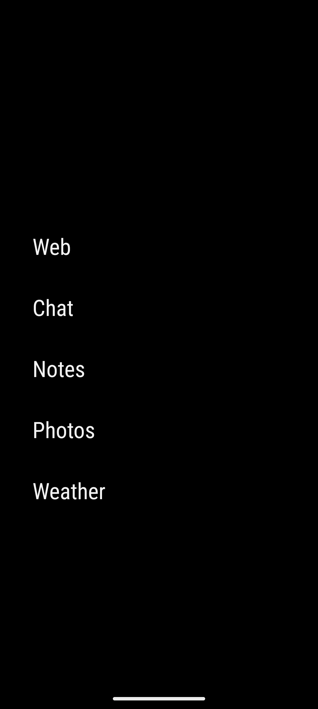

What about YAM Launcher? I think it’s a good compromise between a regular launcher (which it is) and that wellness mode, or whatever it’s called.
Here’s a screenshot of my only home screen. I find it nonedistracting and still useful.
YAM Launcher is available on F-Droid. And I assume it’s available on Play Store as well.
Great suggestion, thanks! My main question was about the fp6 detox menu availability on Lineage OS, but I suppose a good minimal launcher is a good alternative as well, since fdroid is full of FOSS launchers ^^
