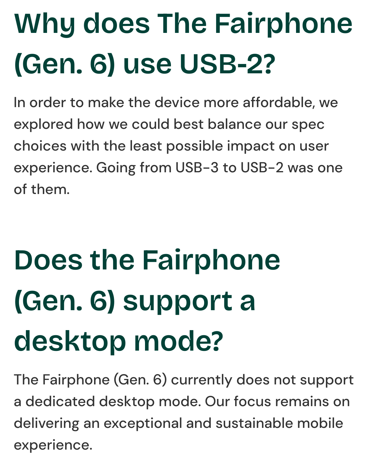

I find the wording of the FAQ page so strange, they say the display port is currently not supported…
It’s a hardware issue. Display out (actually it’s called displayport alt mode) via usb-c requires hardware support, both on the soc as well as the port itself and the connections in between.
Both the FP4 and FP5 have it. The FP6 has a soc that does support it, but apparently they didn’t add the required connections to the mainboard and support to the buttom module. So there is also no way a future upgrade or a custom module could add usb-c 3 with dp alt mode.
