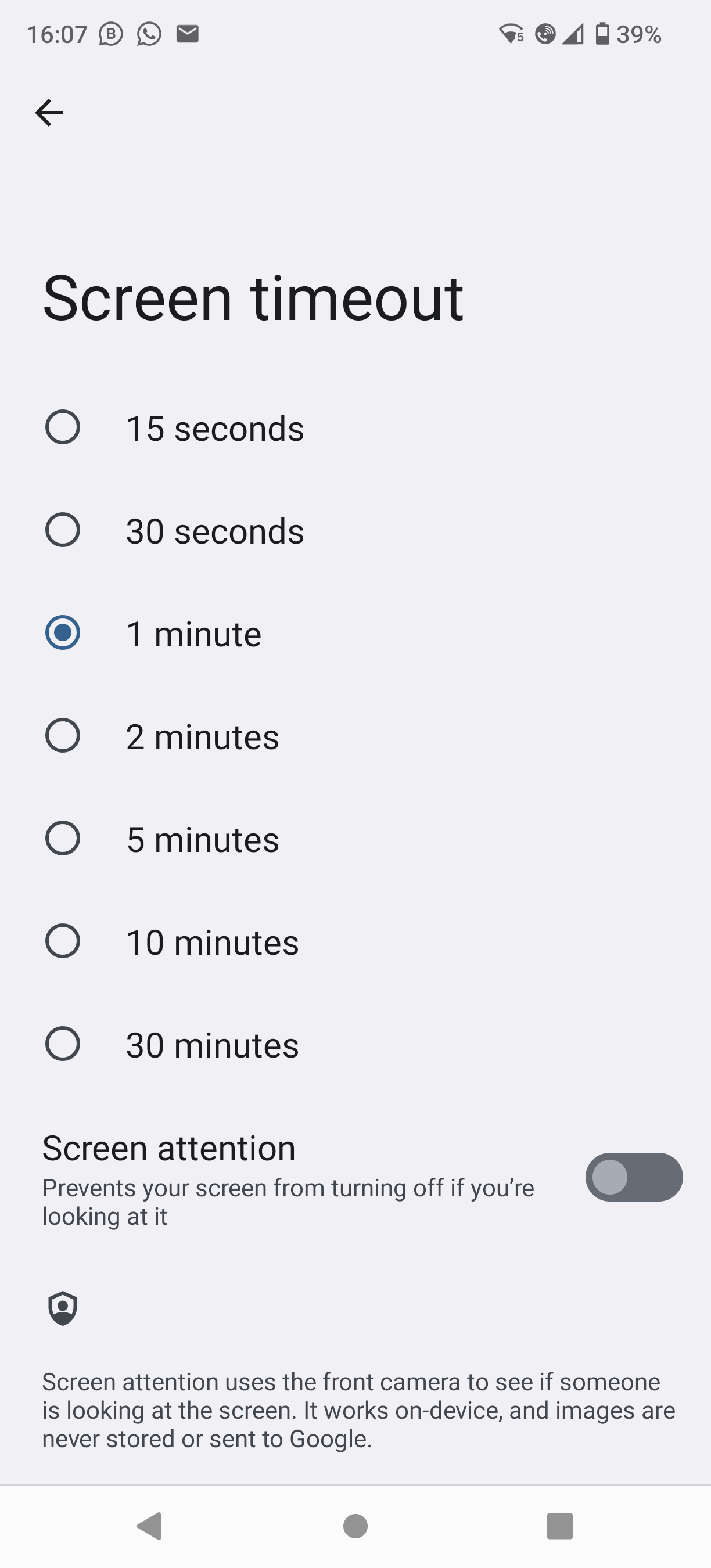

FP5 How to change Screen Timeout
I’m starting to learn Android and this isn’t so easy if you’re used to a intuitif desktop O.S.
My most urgent need is to DISABLE that auto switch off. I don’t even have time to make a note (on my desktop computer, where i can boit down all what is necessary). Now as soon as 1 minute passes, the FP switches itself off, obliging me to re- enable the pattern, which, apparently can’t be removed/deleted anymore.
I never should have defined a pattern (or any other security lock) before finishing my first week of learning and defining the basics.
So:
Q1a) Can I disable the auto-switch-off-phone?
Q1b) If not, can I make it far longer, before it is activated?
Q2. Can I disable to pattern login check? (even temporarily (for open day would help).
THANKS
The phone is not switching off, just the screen locked, just to clarify wording.
Change: settings-display-screen timeout- change as you want

GREAT!
You (almost) saved my life… I feel much more relaxed!
