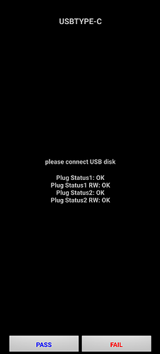

Could you do me a favour and try to run the USBType-C self-test from the Fairphone app when the problem occurs? You need a USB-C thumb drive or similar to run the test.
I.e. start the test, plug the thumb drive, once in each orientation, wait a few seconds until it succeeds, maybe the first time does not work.

Why do you need an extra device in that moment cant you just run the test while connected to car and what does the internal test show you in those moments?
I am running AA over cable. So I need to be disconnected from the car. The test requires a USB “disk” to run.

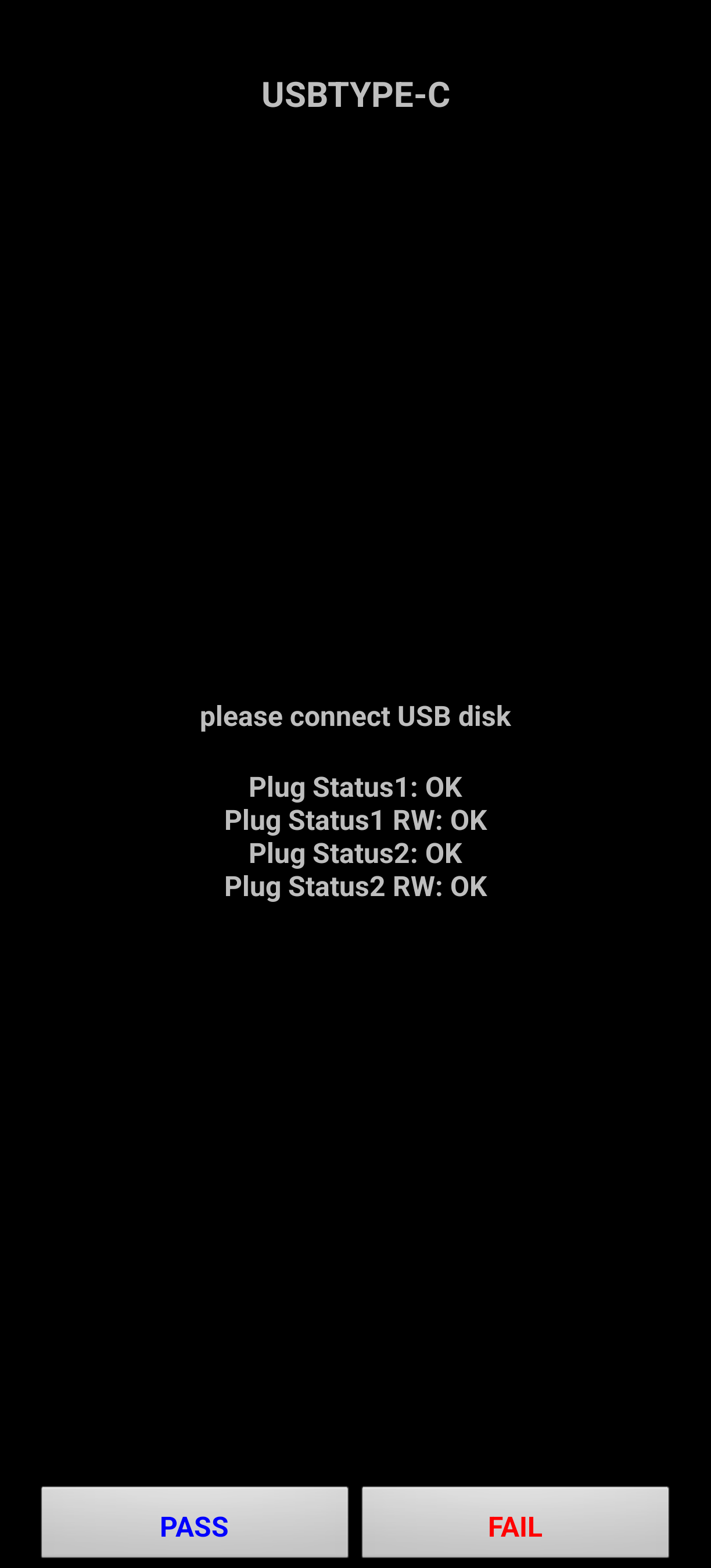

This is the screen after the successful test:
Each plug statuses switch to “ok” in only one orientation of the USB thumb drive.
