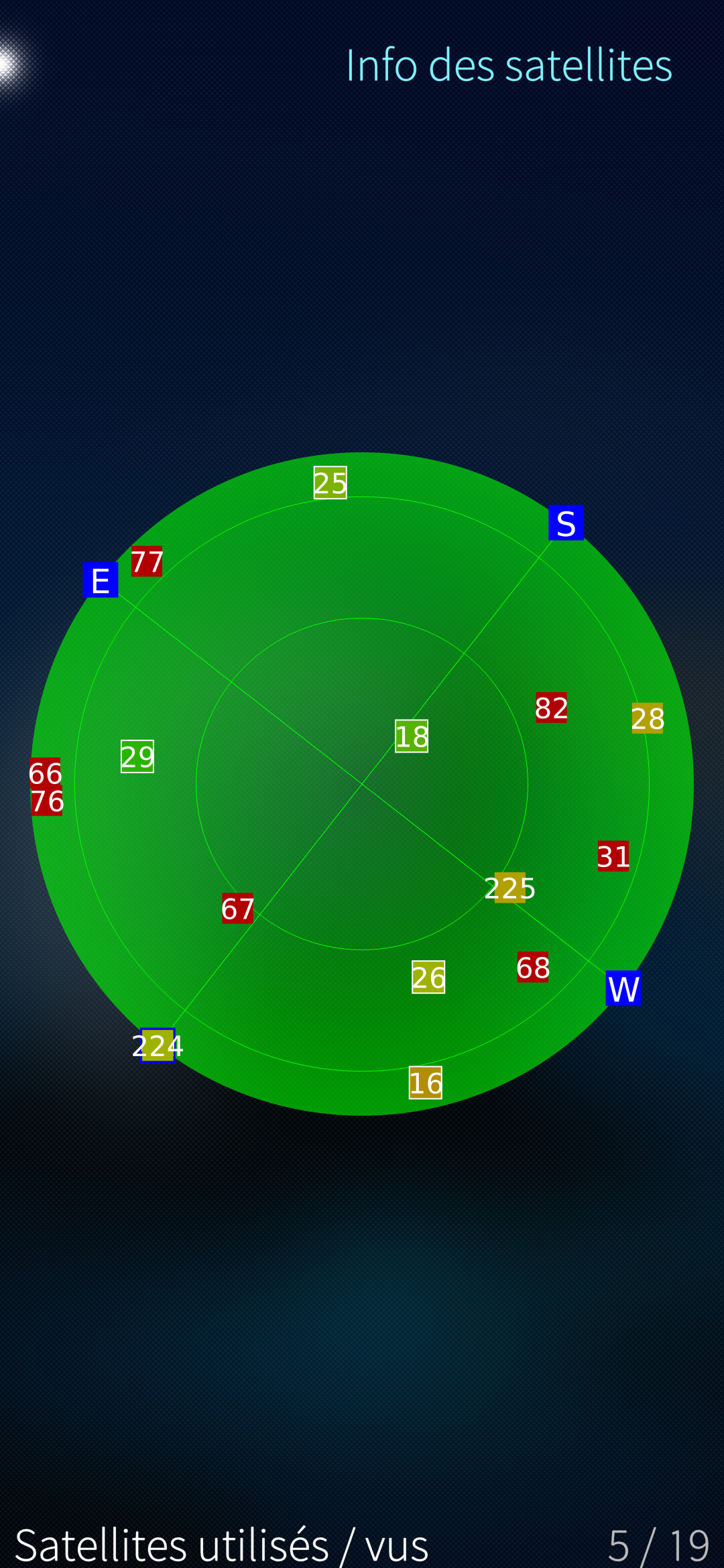

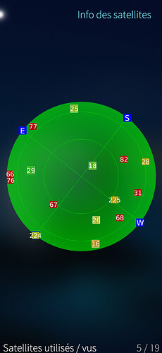

For GPS it took me approximately 1 minute to get a fix :satellite: (walking outside)

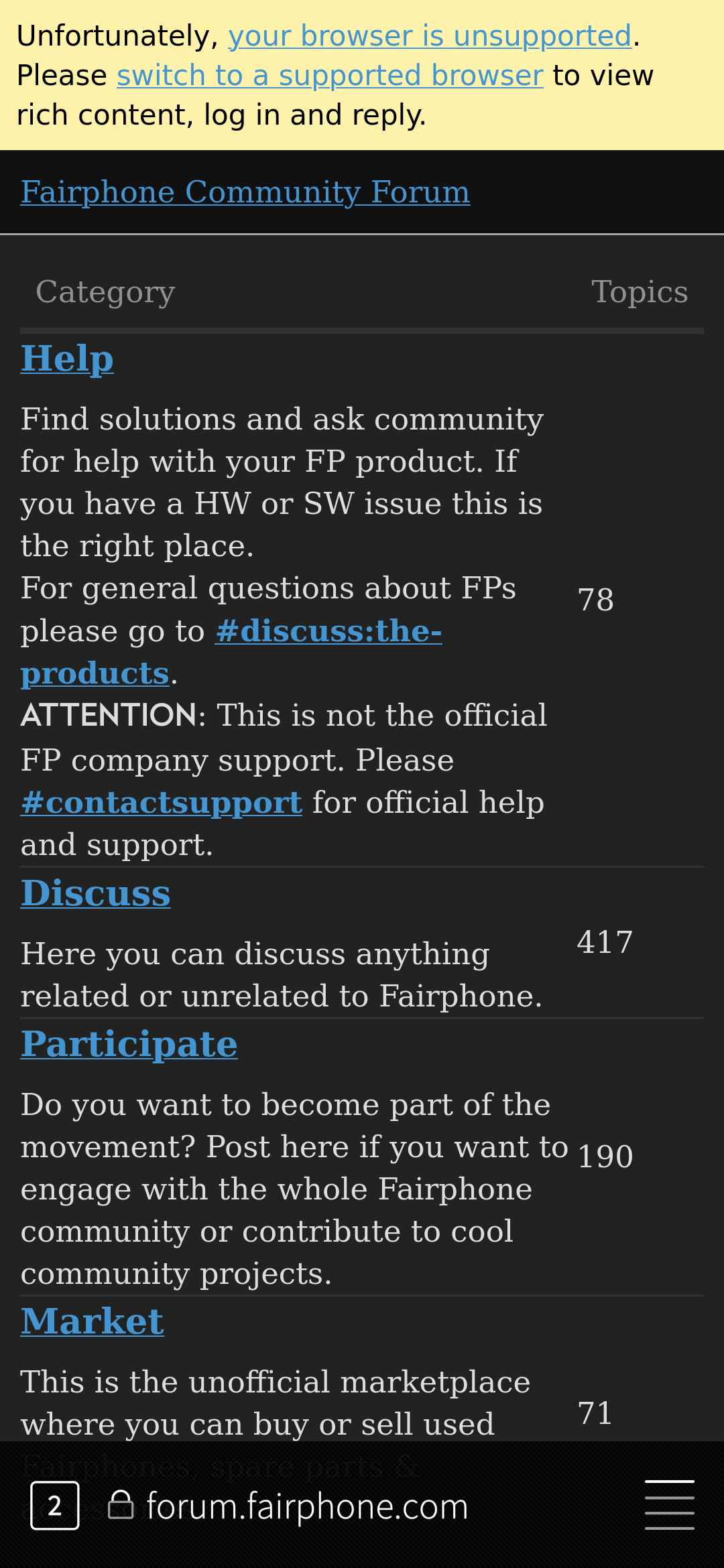

And with the web browser, I’m not able to connect to this forum :sob:
The web browser thing is expected, as the current browser is based on FF78. But there is hope, as there is work on upgrading this ancient piece of software!
