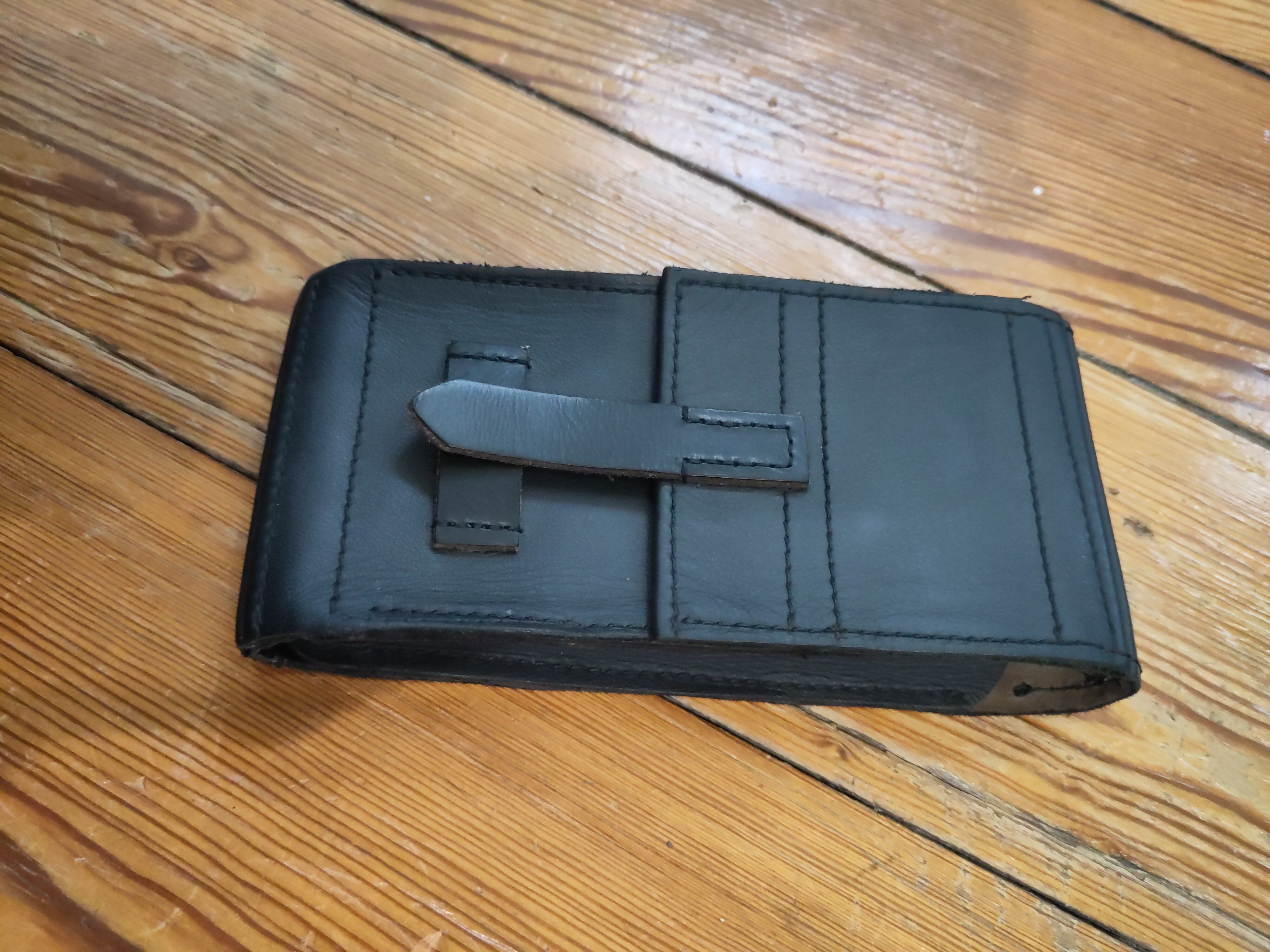

@Meaghan I did end up finding a perfect fitting case at a local leather shop! It works quite well and doesn’t seem to overheat ever.
