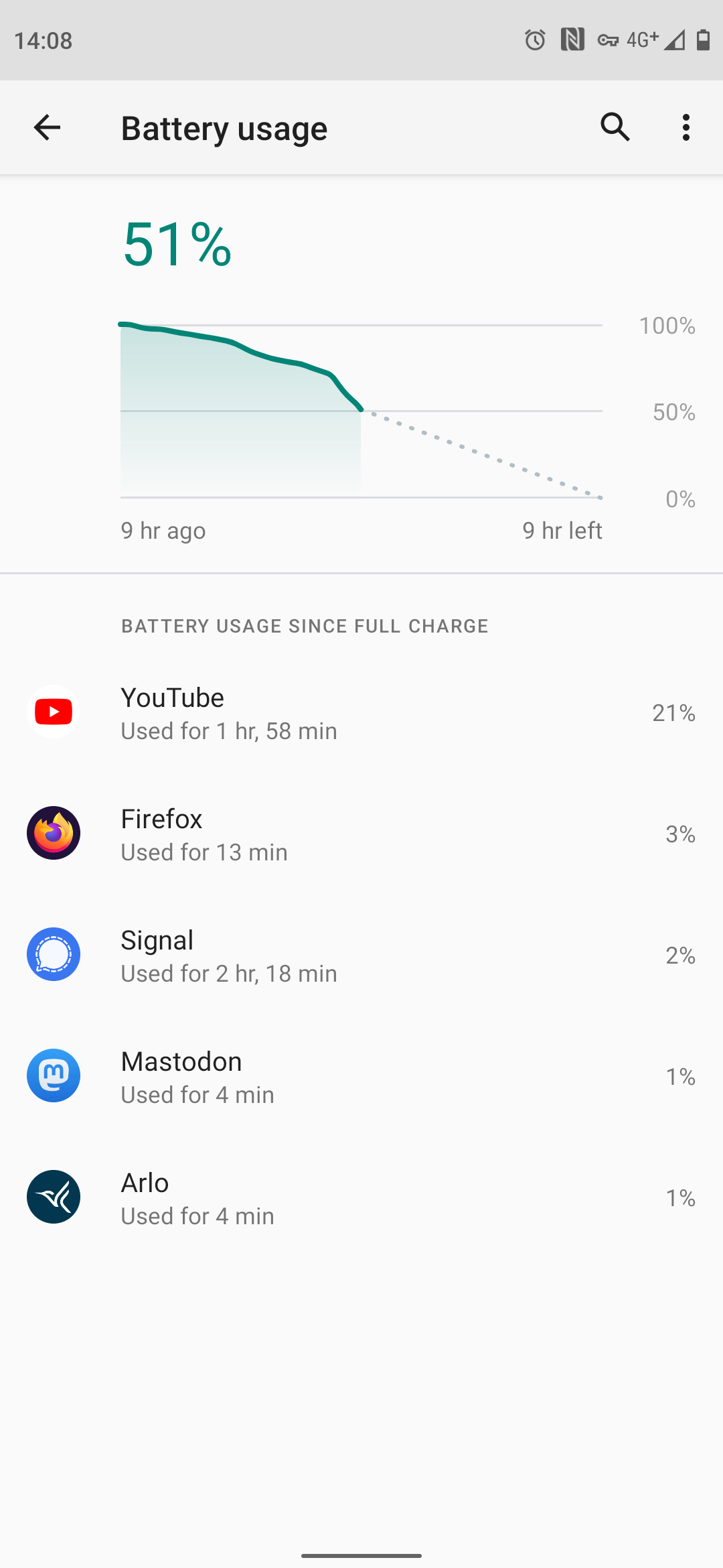

Just as a test, I’ll play a 4K video now for 30 minutes and see what the impact is. Then you can compare. 10 minutes in, device is still cool. Will update later.

When I switched to 5G the battery drain indeed started. But the phone remains cool. It got a little warmer, but definitely not hot, or as hot as my old Pixel 3 can get. I’m also using the stock case by the way.
I’ll do another test with 4G.
Thanks a lot man, Mine only gets “hot”/warm after maybe 30 minutes or so. So i guess it’s that (5G), paired with the high resolution. And on youtube or netflix it works fine even with streaming data its more on sites where I stream football games or movies without paying for it. I really appreciate your help. Was afraid my phone had something wrong with it but guess it should be fine. Just disable 5G and set the quality to a max of 1080x 2340.
I continued the test with 4G, seems to have a very similar if not identical drain (maybe it’s slightly less battery hungry, but it seems minimal). So I see no need to disable 5G. Changing the resolution probably doesn’t change the drain either, since it works fine with WiFi. So it could be that the 4/5G modem is the cause for the drain. So anything keeping it busy might have the same effect. In terms of thermal energy, it didn’t change anything, it’s still cool.
