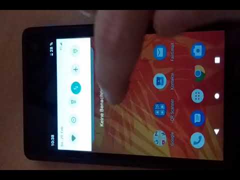

For visualizing the issue I’ve recorded a 2 minute video of the issue here:
The first half shows some erratic behaviour on medium brightness, then at position 1:30 the fully erratic behaviour with low brightness setting can be seen.
