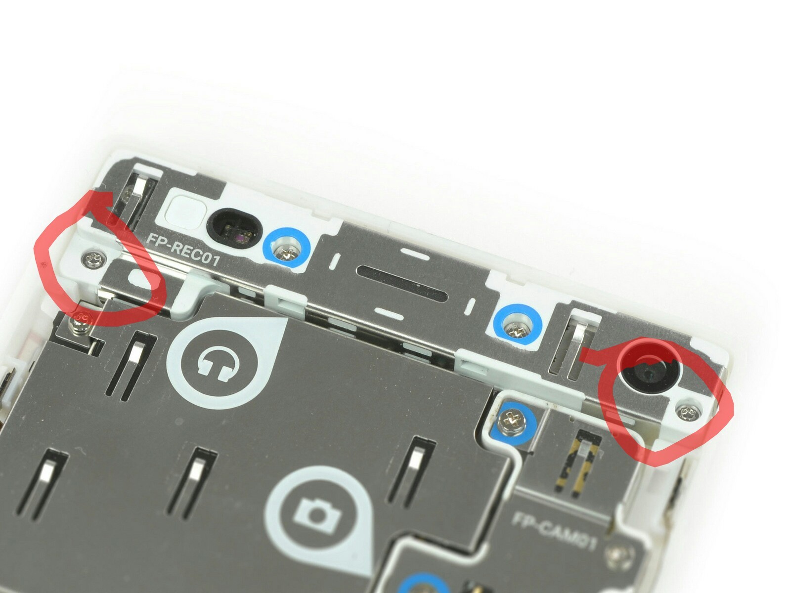

You could try to get the headphone module out, like described in this iFixit Tutorial and then cautiously dismantle the module itself by opening these screws with a small torx screw driver:
Then very gently try to push from the inside to get the headphone plug out.
