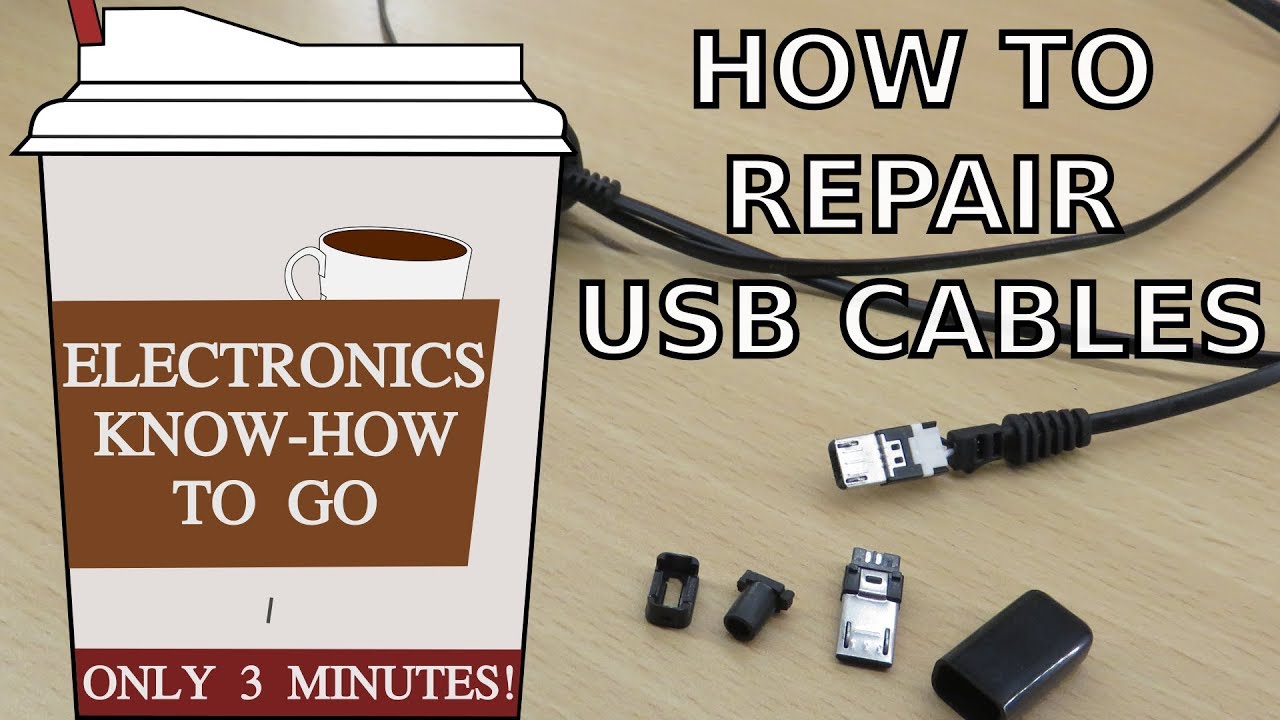

The cable itself is hard till impossible to repair. All the cables are moulded around the connectors. The only option could be to solder a new connector to them what needs advaned soldering skills and expensive equipment.
My experience is to use not the cheap cables. Anker or Fairphone cables are my recommendation.
Maybe not so difficult for some and no expensive equipment
