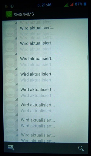

After some time and filling up my FP1 with a lot of SMS messages (some hundreds, maybe thousands?) I noticed that during scrolling through the list of SMS the messages “Is beeing updated” (“Wird aktualisiert”) is displayd.
This happens in the “contact” view as well as inside one “thread” view.
It happens more if I scroll very fast.
It happens more if I limited the CPU to lower frequency (497MHz), but doesn’t vanish at max 1200MHz.
It just takes 1-2 seconds, but it is annoying, while I cant stop scrolling at the desired point, while I cant see the name/icon of the contact I look for…
Althoug I am aware, that some thousands SMS are quite a lot, I can’t understand how the OS/hardware is not able to deal with this, as an SMS has just some KB (or less) of size and RAM/storage rate should be at least some MB/s.
Playing HD videos or browse on heavy content websites should stress software and hardware quite more and runs smooth at my FP1.
Am I wrong?
Can anybody confirm this behaviour?
Any explanation, solutions or workarounds (without using a differen message app)?
