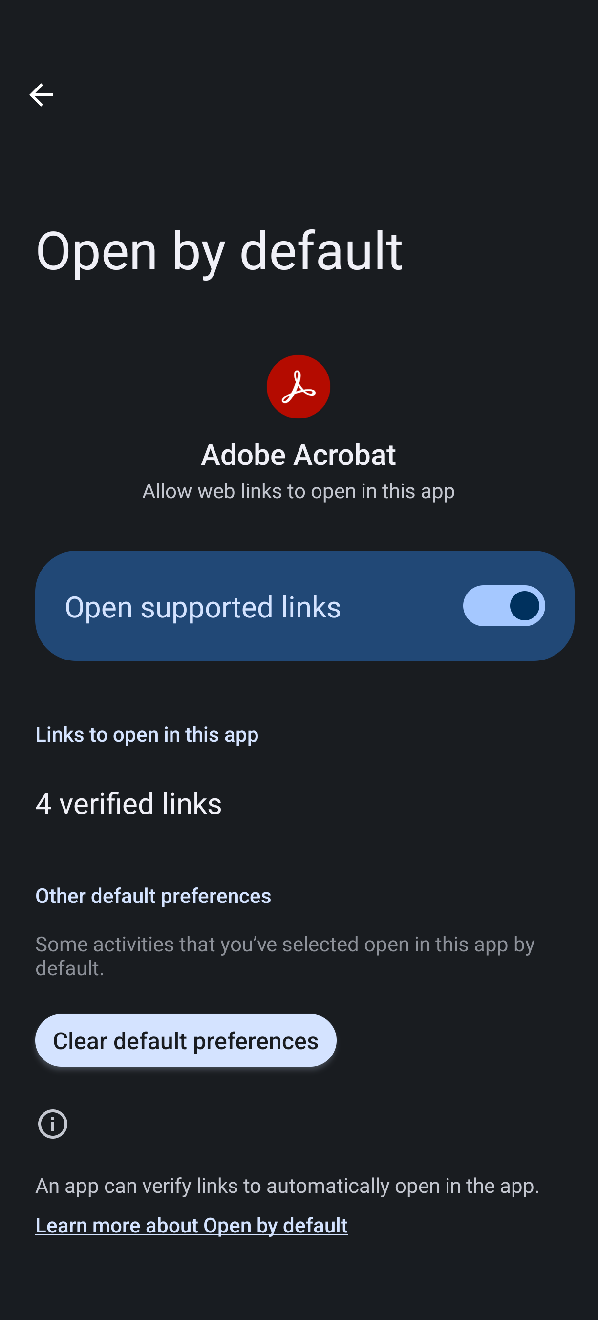

Try to go into adobe reader’s app-info and tap “open by default”. There should be options to link pdf’s to AR.

Did you tap on “4 verified links” to enable those 4 links? This should do the trick, doesn’t matter what file manager you use.
Yes. And also disabled it.

go to settings → apps → all apps → Files by Google → open by default → clear default preferences.
you can turn of “open supported links” but that shouldn’t be necessary, and could cause other problems.
