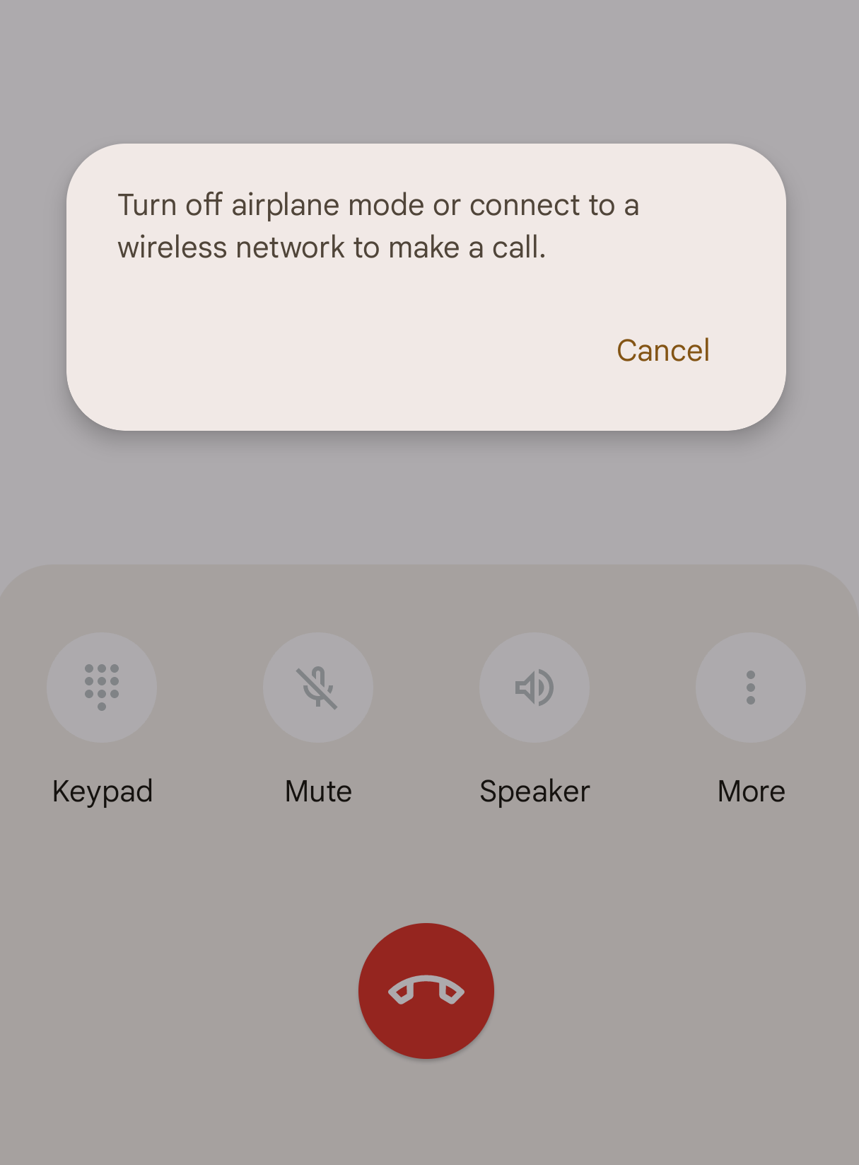

One more point.
The error message I receive when trying to wifi call is incorrect and misleading.
āTurn off airplane mode or connect to a wireless network to make a call.ā
Since I am a wireless network, the error message is inappropriate.
##4636## shows āWiFi Calling Provisionedā
