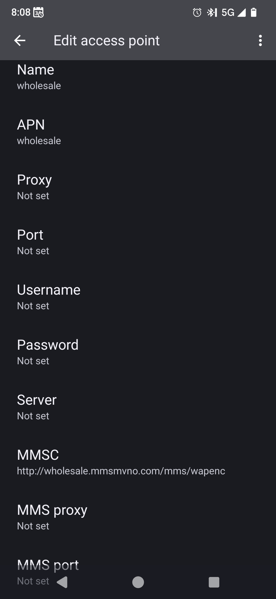

I’m currently using FP4 on Tello and can get both 4G and 5G, no apparent issues. (I am using lineageOS.)
I had to adjust my APN (Access Point Name) stuff to get it to work.

Are you sure that’s all? Tello said add that URL and the following (much is automatic… not all).
proxy: (leave blank)
port: 8080
username & password: (leave blank)
server: (leave blank)
MMS Proxy: (leave blank)
MMS Port: (leave blank)
MNC: 240
authentication type: (leave blank)
APN type: default,supl,mms
protocol: IPv4/IPv6
MCC: 310
