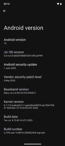

Some info that might help identifying the culprit:
After I installed /e/OS and not locking anything, the OEM-unlock-switch was grayed out (and turned on). However, just now I noticed that this is not the case anymore, I can toggle it (ain’t gonna try). All I did in the meantime was flashing APatch-boot.img and installing an app or 2. Maybe it means nothing but it’s kinda weird that the behavior is not consistent, isn’t it?.
By the way, the /e/OS updater provides a beta-update to version 3.0.4, here’s a link in case someone can make use of it: e-3.0.4-a15-20250708507307-official-FP6.zip
You are ore still on e/OS and not FPOS correct?
So thats how it should be I think.
Now your FP is also rooted. Not sure why and how ths can be related or not.
