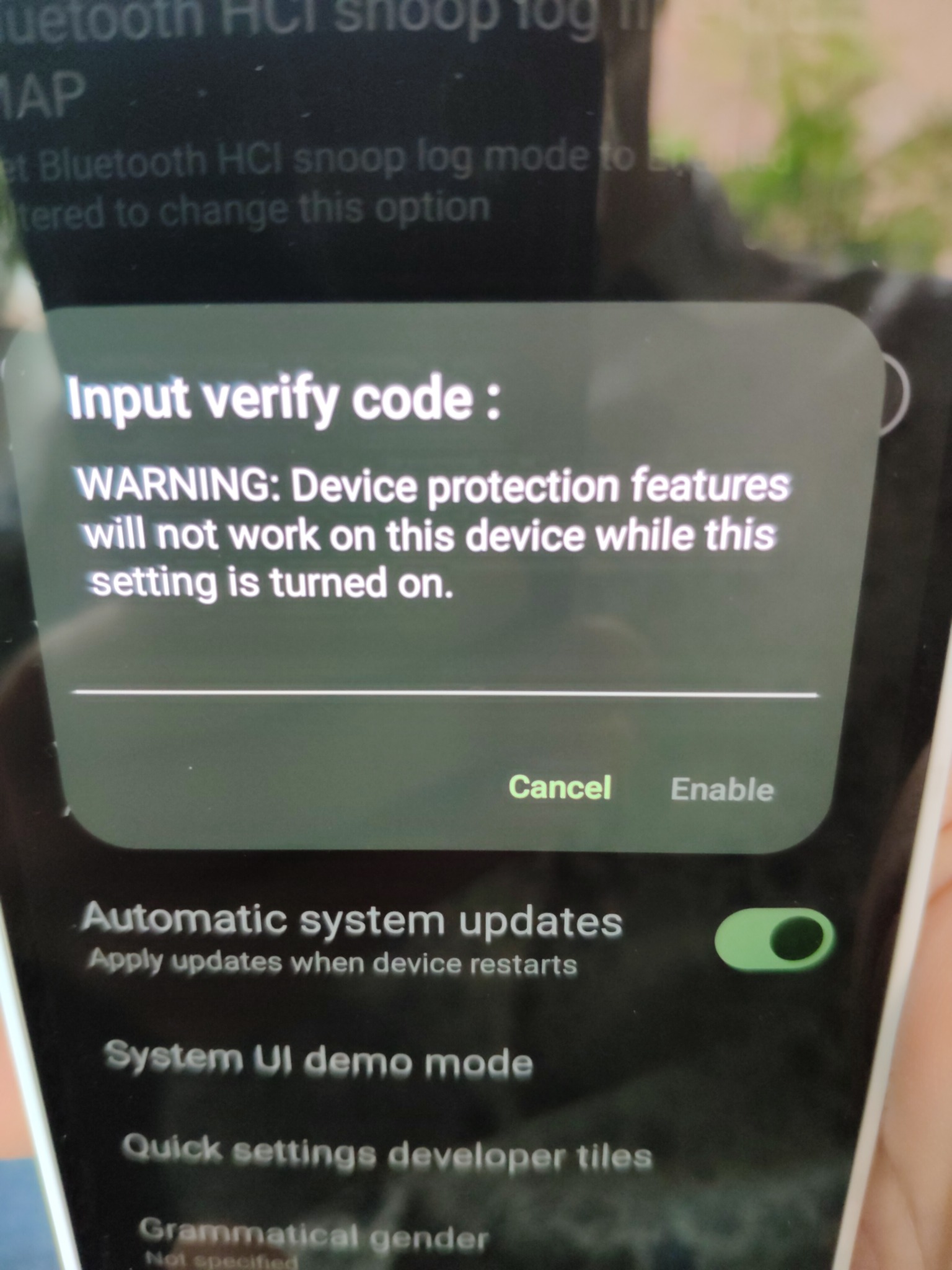

Maybe post a screenshot of the OEM unlocking setting
I followed the instructions, and cannot get past step 4. This is how it looks on my phone:
Maybe I am wrong for the reasons why I cannot unlock this device, but I cannot unlock it directly on the phone (see picture) or using fastboot (see my previous post).
But didn’t you say that you have the OEM unlock code? Can’t you just type it in? I mean, this input dialog seems exactly the right place to do that. Is it not possible? (Sorry if I missed something obvious.)
Man, I feel so stupid. I didn’t see that this line is a field to type in… :man_facepalming:
I was able to unlock it now. I will update this post when I succeeded (fingers crossed stupid me gets this done)
UPDATE: Everything else went seamless. I’m now running /e/OS! Thanks so much for everyone who helped!! Hopefully other people not seeing the line in the OEM unlock as the field to type in the code, can find the solution here.
