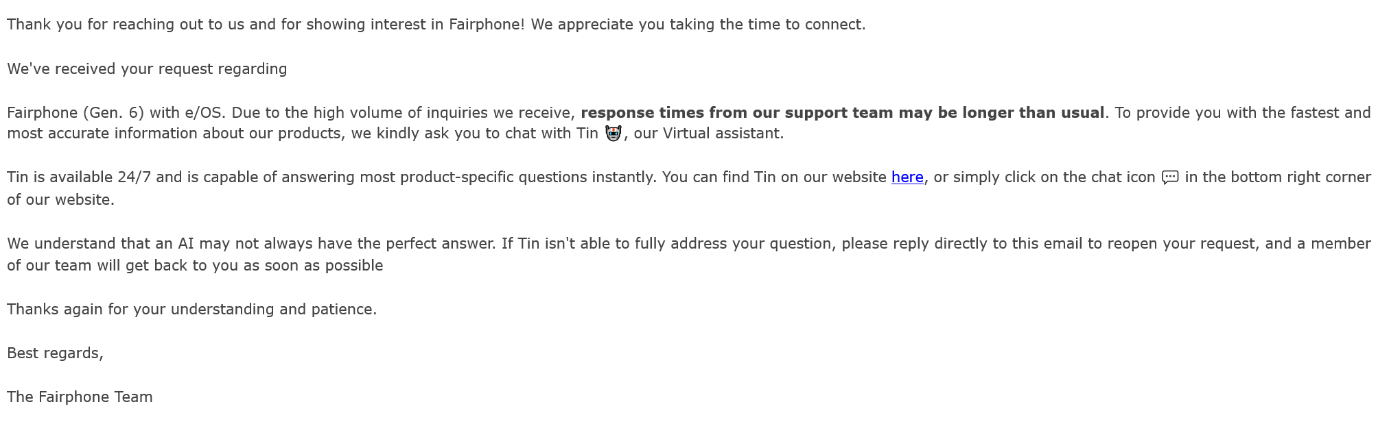

A month ago, I contacted FP about this problem. I never received a response. The lack of communication and the fact that, to this date, no (paid) solution, upgrade, or repair has been offered is not what people expect from an “fair” company … At the very least, a brief message such as, “Our technicians acknowledge that there is a problem and are working to find a solution,” would be nice …
