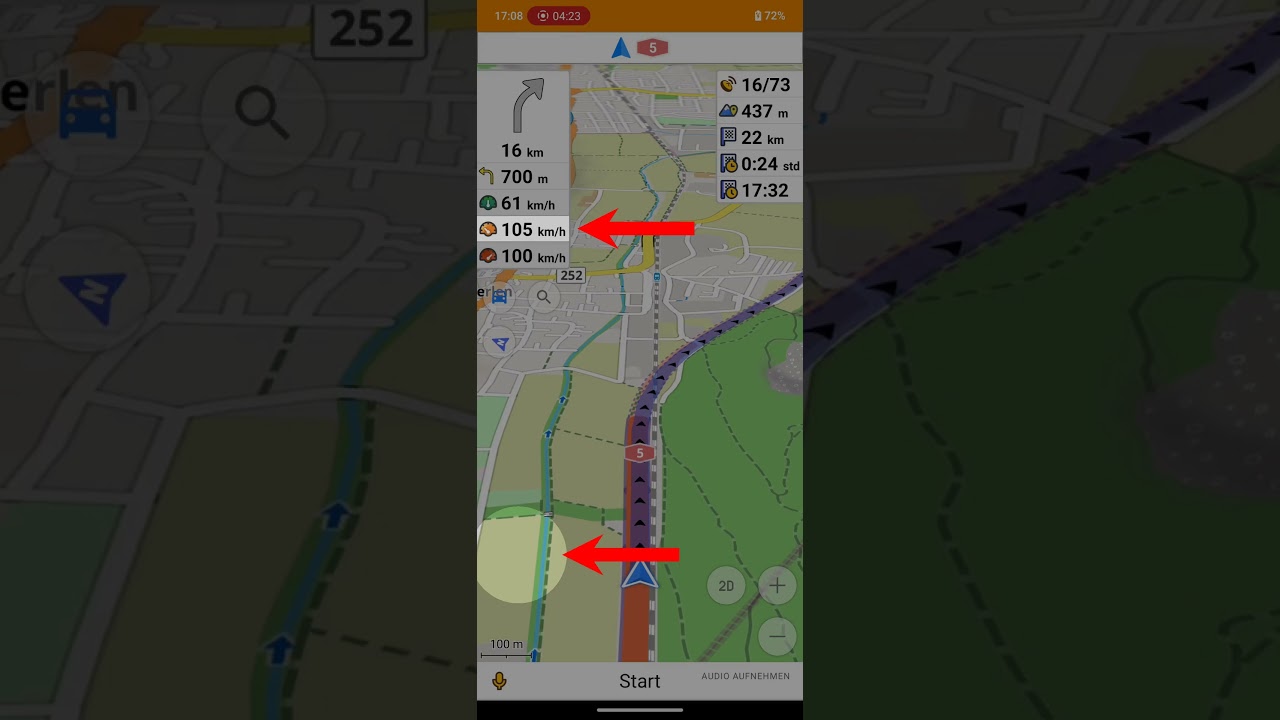

I can confirm the problem here on a Fairphone 5 with LineageOS 22.2 (Android 15). I uploaded a short demo clip on Youtube:
I just tested exactly the same software stack on a Fairphone 3 (LineageOS 22.2 and OsmAnd 5.0.5) and the GPS speed was rock stable!
So I am very confident that this is a Fairphone 5 hardware/driver issue.
