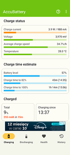

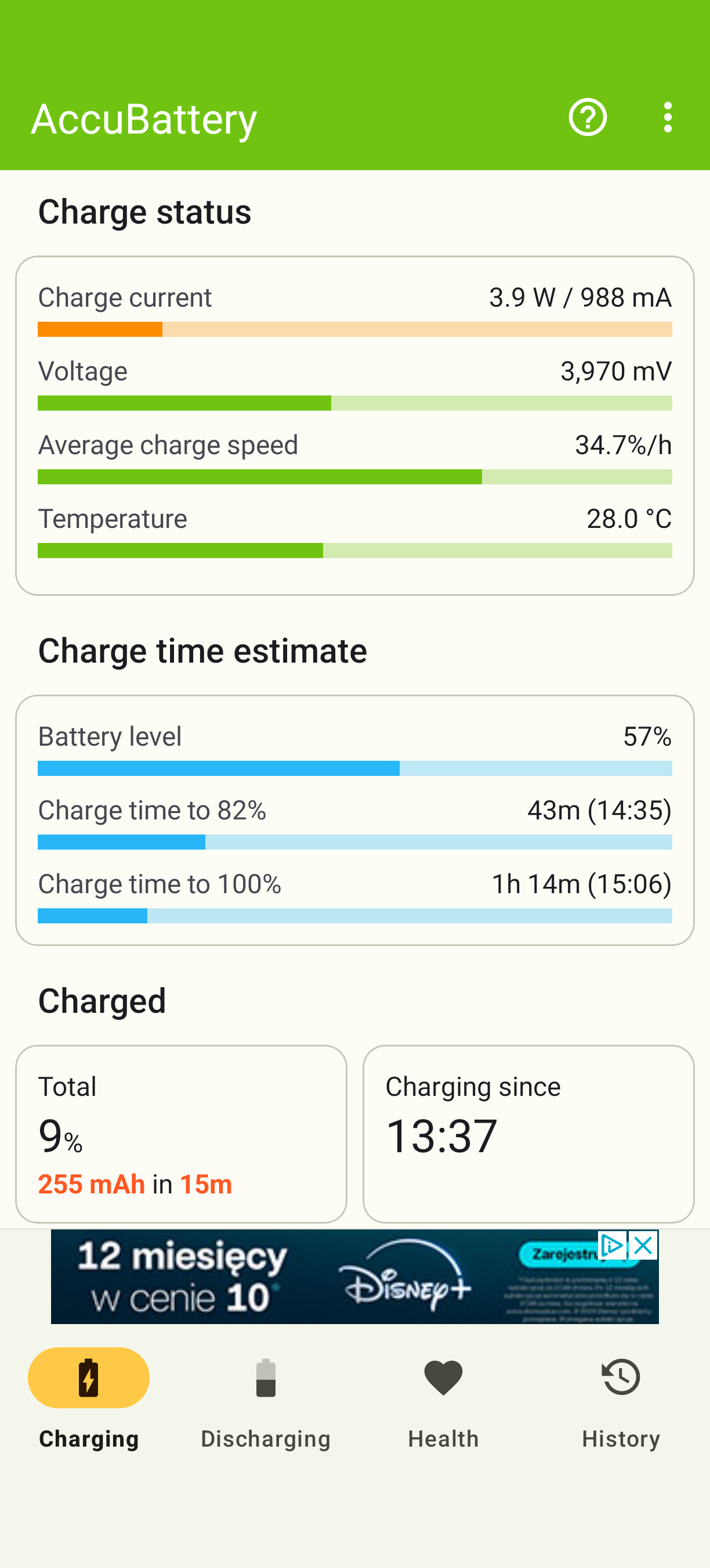

This is mine, eco charge, for reference

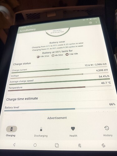

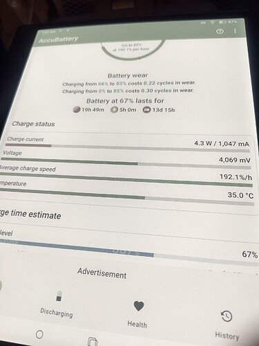

@Martin_Anderseck could you please have a look here? These are the shots from charging my onyx e-book reader, on a brand cable but with my mobile devoted Baseus charger.
When charged as the only device the current is higher but the temperature rises above 40, when charged simultanoeusly with a mobile (the second shot), the current goes down and the temperature is OKayish.
Is a charger or a e-reader to blame? I found an old charger laying in the drawer and as it is weaker, I can charge my e-reader within acceptable temperatures but I was wondering what is happening here.
It’s the fault of the device to be charged. The charging electronics is in the device, it should limit the current to something that is healthy for it. But looking at these numbers (3 amps is quite something) I’d indeed take a charger that delivers less to extend the lifetime of the device to be charged. On the other hand: If the battery was huge this could be acceptable. And one more thing: If the vendor says the operation of his device is only safe when using a specific charger then this might be okay as well. USB specifications probably don’t include 5V/3A, either, but I haven’t looked it up.
