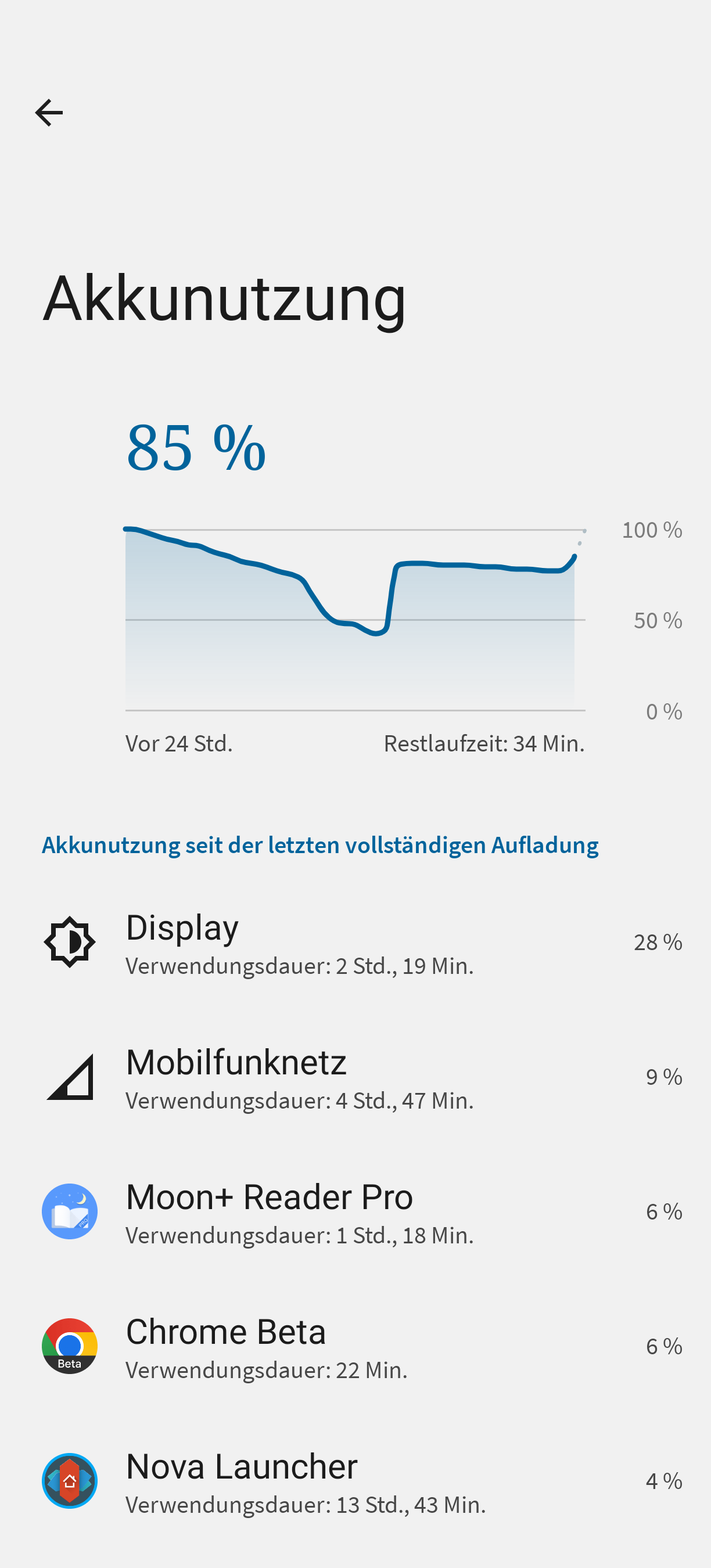

Hello everyone, I’ve had the following phenomenon with FP5 a few times now.

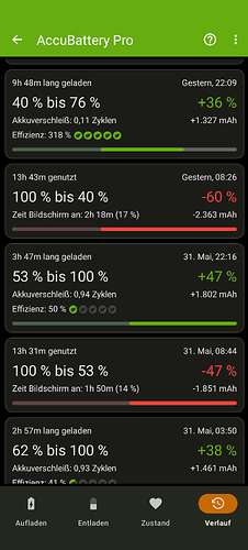

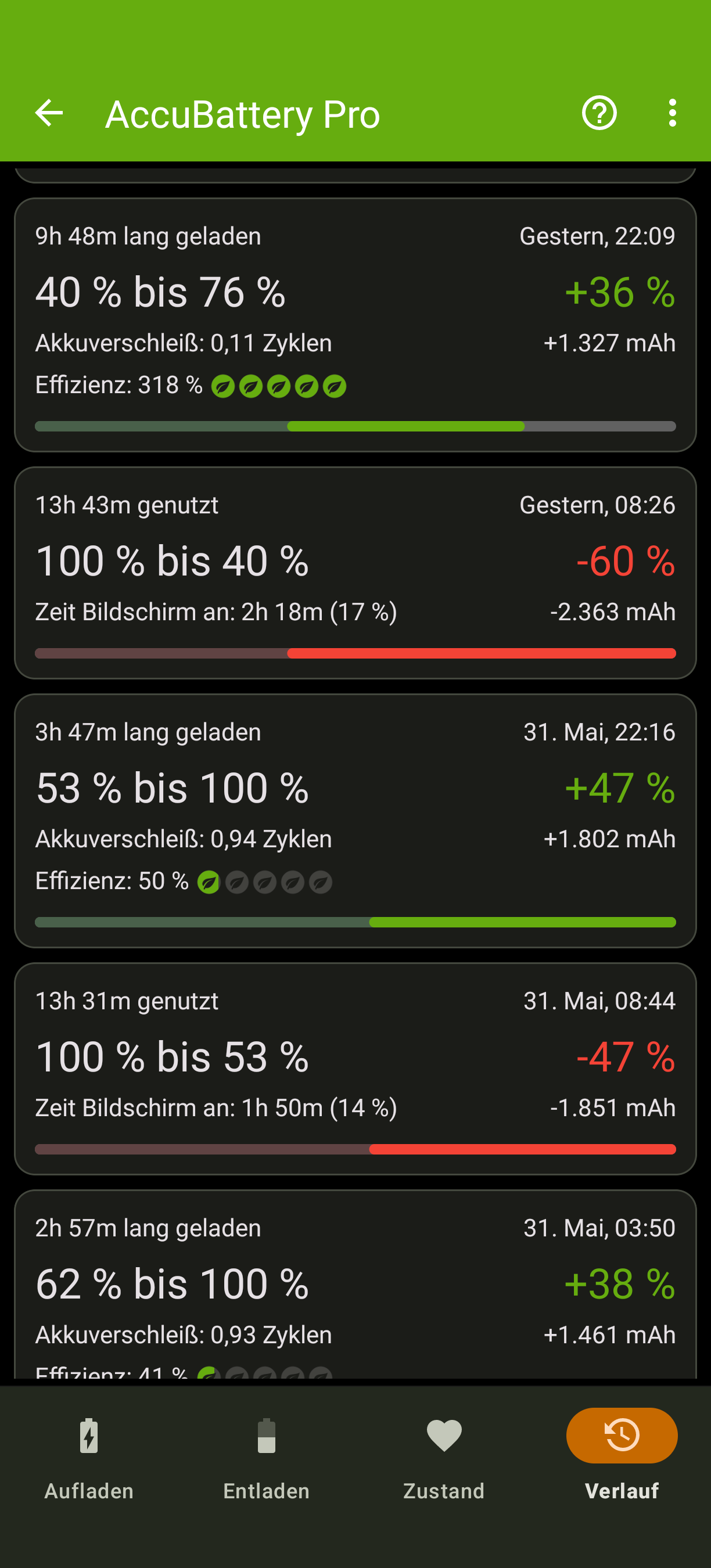

The phone does not fully charge. I plug it in in the evening and in the morning it has between 40 and almost 80 percent. Battery saver to 80% is disabled. Then, when I unplug and plug the charging cable back in, it fully charges. So you have to take a quick look at night to see what’s going on. See screenshots. I even replaced the cable and the charger, without success.
In the screenshot with the battery usage from the settings, you can see that it charges quickly in the middle of the graph, but it only goes up to 76%, which you can see in the other screenshot from accubattery.
