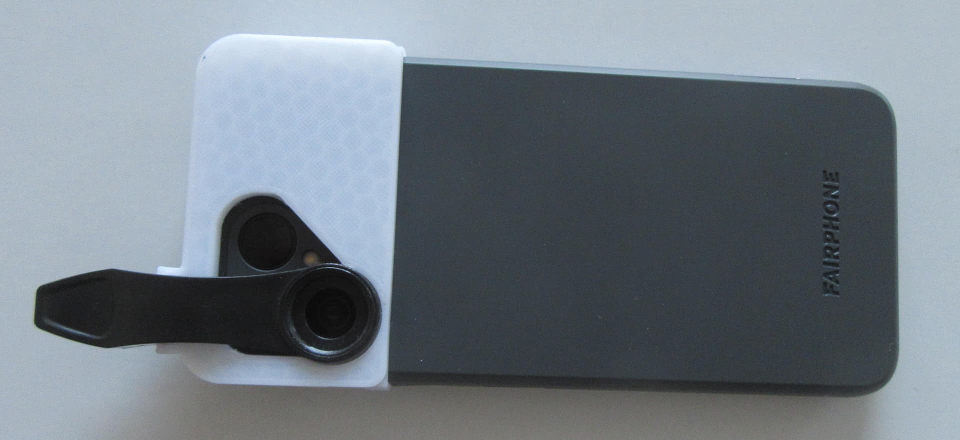

I settled for a budget priced lens kit with a simple clamp to hold the lens.
Looking at the kit, it seems intended for (I)phones 6-10mm thick.
Two clamps are included, a slim one covering a single lens and a second one intended for dual lenses phones.
The fp4 is not slim enough for the two lenses clamp, but fortunately it is possible to make the single lens clamp fit with a small fix. And it does not cover the light sensor.
It is light, the lens and clamp weight less then 60 grams.
A small fix.
To avoid the lens to rotate or being displaced while adjusting the focus ring, I printed a mount to hold the clamp in place.
The FairPhone 4 case and dummy by nainno - Thingiverse was used as base, and modified to hold the clamp firmly in place.
