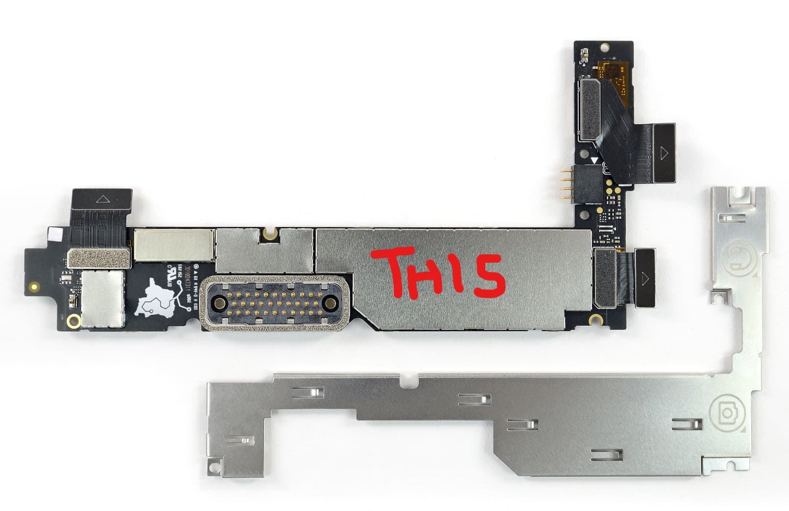

The only issue was pulling off the shield in Step 9. Specifically, I removed the top shield on the front side, so
I had never removed a shield of this type, and initially didn’t really know what to do. Initially I got a very small screwdriver and carefully got it in at the base of the shield (where it touches the circuit board) and carefully wedged up the the shield. Then I discovered that the shield has little dents/holes on the side. With a kind of hook tool,
I managed to “hook” into those holes/dents and gently pull upwards. Doing this a bit from all sides (it’s difficult at the bottom end as the shield is close to the screen connector and the other shield) I pulled it off. Sorry if this is totally obvious to you, I had never removed a shield before and struggled, so I decided to document it here for noobs like me!

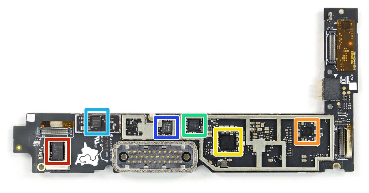

Having removed the shield, I now had direct access to the power management chips which, according to posts here, cause the problems due to bad solder connections. The iFixIt image below really helped me, as it clearly shows
  • in orange: Qualcomm PMI632 power management IC
  • in yellow: Qualcomm PM8953 power management IC
I think the issue is with the PMI632, but as I wasn’t sure, and there was nothing visible (even under the microscope), I decided to give both the heat treatment.
