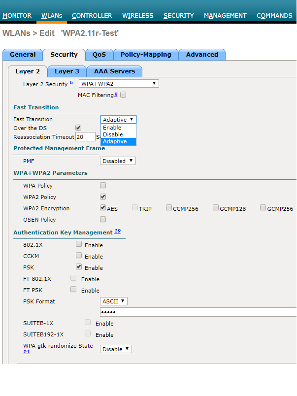

My reading of @stephan.brunner 's post is that FT is in fact operable with his FP on his Cisco router as long as the additional security parameter is included (PSK being a means to prepare the device with the new key before switching actually takes place).

Reading around it seems that problems with Cisco access points are frequently reported when implementing “Adaptive”, including with Android 10 devices with Qualcomm chipsets. May have to wait for A11 for a fix.
For the record: it would appear that “Adaptive” is a Cisco trick which allows iOS devices to benefit from FT, while hiding FT capability from other devices, so as to avoid confusing some non-11r-capable devices and having to provide IT support for them. So “Adaptive” does FT and it doesn’t, at the same time. It would seem this is confusing some devices that aren’t made by Apple.
From what I can gather, this is a Cisco / Apple “huddle” that is catching out some devices that simply apply the straight standards … I may not have understood correctly.
There is a standards-compliant configuration of the router which provides FT for devices that are compatible (Apple or not), and WPA2 for the others. The drawback is that this reputedly causes problems with devices that can handle WPA2 but have code that gets confused by the 11r FT announcement. I would not expect the FP3 to have problems with this configuration. I think this is the configuration referred to by stephan.brunner.
