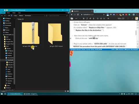

  1. Open the folder where the file is downloaded, usually the “Downloads” folder
    (in Google Chrome you should click Show in folder).
  2. Right-click on the file fp2-gms-00.00.0-manual.zip and select
    Extract All…
  3. A new menu will open.
    Click on Extract. Close the window that appears!
    (if a window titled “Replace or Skip Files” appears, click
    “Replace the files in the destination”).
  4. Now there are two folders with the same name.
    Double-click on the one with NO zip.
  5. Plug-in your phone with a DATA USB cable: In case you are not sure
    REPEAT the procedure from this point with a DIFFERENT USB CABLE!
    On the market, there is big number of USB cables that are only suited for charging your device, but not to connect it to a pc
