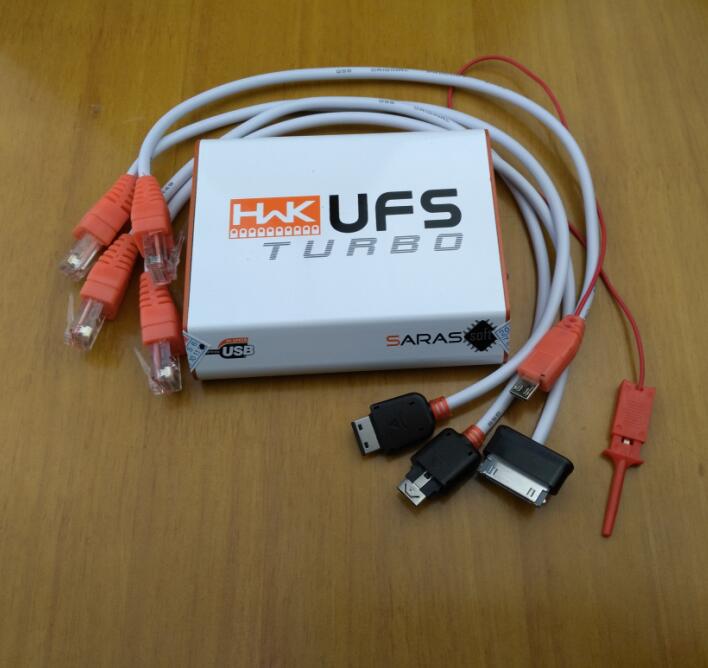

Hello All!
I have a friend with bricked FP2 Mainboard (Boatloader somehow locked), this is not possible to to flash the device via Fastboot. (Bootloader doesn’t allow to flash every partition)
Fairphone support of course refuse to repair this problem on warranty
I know, that Qualcomm Device are not brickable (when you have the right tools)
I have all needed Tools:
UFS HWK Turbo Box with Qualcomm 801v2 Support
EDL Cable (Deep Flash Cable)
Can someone from the Fairphone Team or from our gurus give me access to the original FP2 boatloader or tell me the procedure for unbricking?
FP2 is a “rare” device, so Information on XDADevelopers is verylimited…
It would help me and many other people haveing the same problem…
