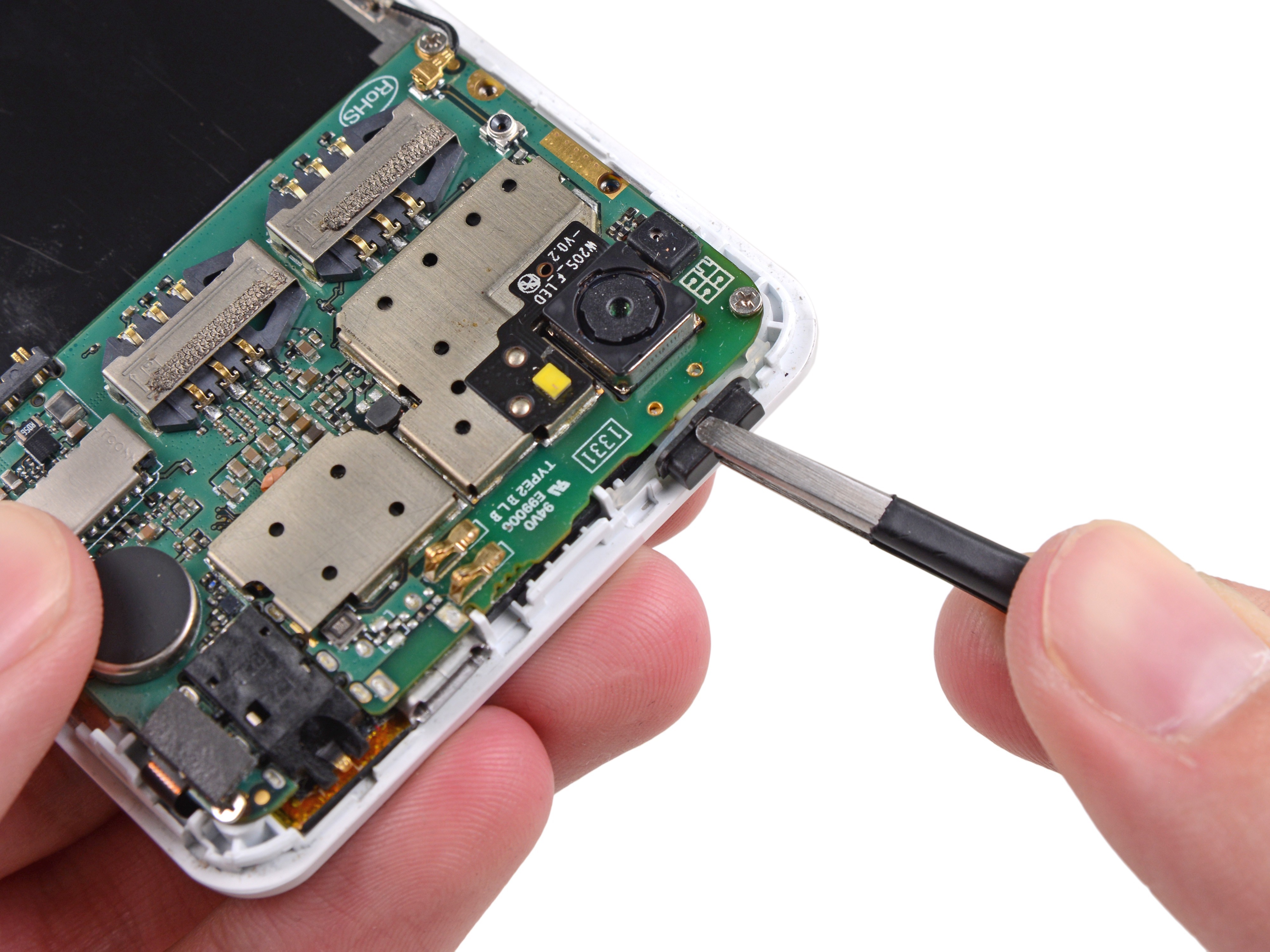

I looked at your picture more closely again. It seems that your phone got pretty battered in the region of the power button.
If you’re giving your FP1 away anyway, you could take it apart, using the guide on iFixit.com. In step 13, you’ll see this picture:
https://d3nevzfk7ii3be.cloudfront.net/igi/GOlFZLPjbdAQ4XAK
Maybe it’s just enough to replace the power button with a new one for 2,30€ (opposed to 118€ for a new motherboard).

@Mario_de_Vries : how you came INTO this mode as you have to use the power button also?
I guess your power button now is in a permanent-pressed-state, could this be?
But I don’t know what the consquences of this are.
I would try to open it up and see if the power button only is clamped and maybe you can temporarly un-stuck it…?

You will not give open-up the phone a try and have a look at the power button?
Suggestions you can find here and here
