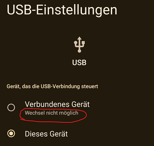

I have a problem with my Fairphone 4. I wanted to connect my FP4 with my computer via USB to my Windows 11 computer. And for the first time it didn’t work and I still can’t get it to work.
I always get this error message:

It IS an error message.
He attempts to switch “Choose the device controlling the USB connection”
from “This device” to “Connected device” and when he does the message “Switching not possible” pops up.

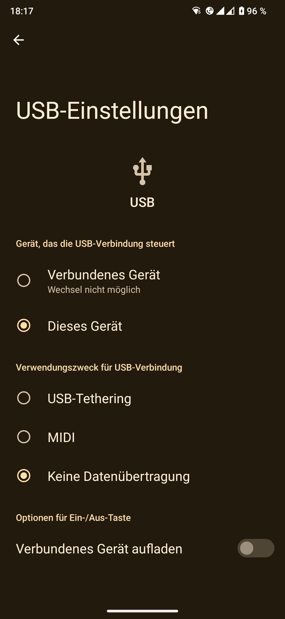

I assume you just want to establish an USB connection for file transfer. Ignore these two control options. Instead, scroll down to the option “data transfer” and choose that.
Depends on what you call an ‚error message‘. It just tells you, that this option is not available at the moment. But anyway, it’s not relevant for the connection at all.
That’s the problem, it’s just not possible. It is displayed to me. “Change not possible / Wechseln nicht möglich” when I tap on “Connected device / Verbundenes Gerät”.

The lower functions are only USB tethering and MIDI. They even work. At least the Windows PC recognizes them. But I can’t get the other functions to work.
Then check your cable is a data cable or try another cable. You dont touch the upper part to transfer data.
As I already said, that’s not the problem, you are on the wrong path.

You are right:
Here is the whole picture. I do not have this option to choose from. I need to talk to my admin so that I can get into developer mode.
I have used several cables. I also have the cable from my Oculus Quest 3 that streams the data between the PC and VR glasses and that doesn’t work either. I very much doubt that it has anything to do with a cable.
If your phone is administered (maybe for work) then the file transfer option has probably been disabled through MDM. So you’ll need to talk to your admins to get that, but you don’t need Developer options, if that’s what you’re referring to.
If the PC is a work PC then check your permissions there, too. Just explain your complete use case to your admins.
