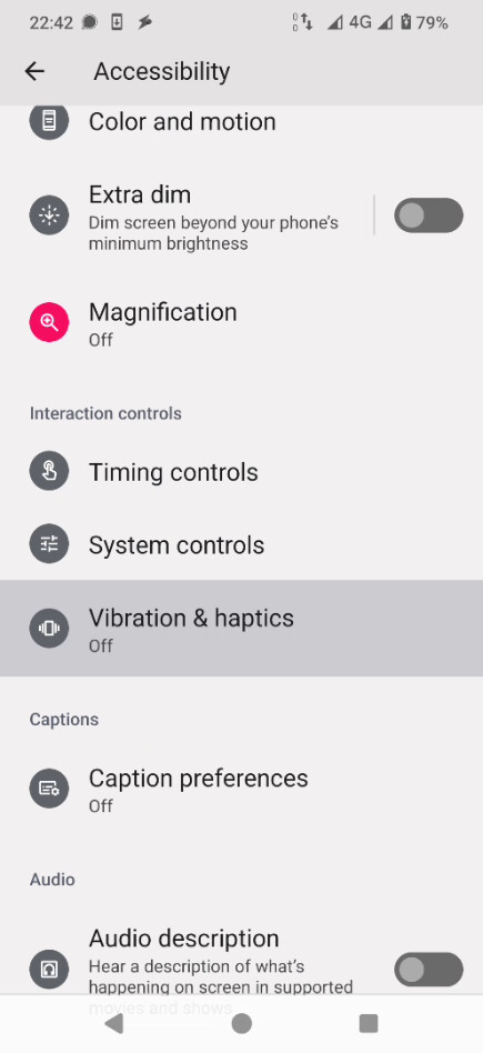

Disablig haptic feedback should take care of any vibration:
Yeah sure but I don’t wanna disable any kind of vibration.
It is clearly related to the Charging Control. I also checked a different charger etc.
Everybody can try on your own.
Enable “Changing Control” and limit charging percentage to e.g. 80%
Wait until this value is reached.
Phone will constantly vibrate then, which is annoying of course.
