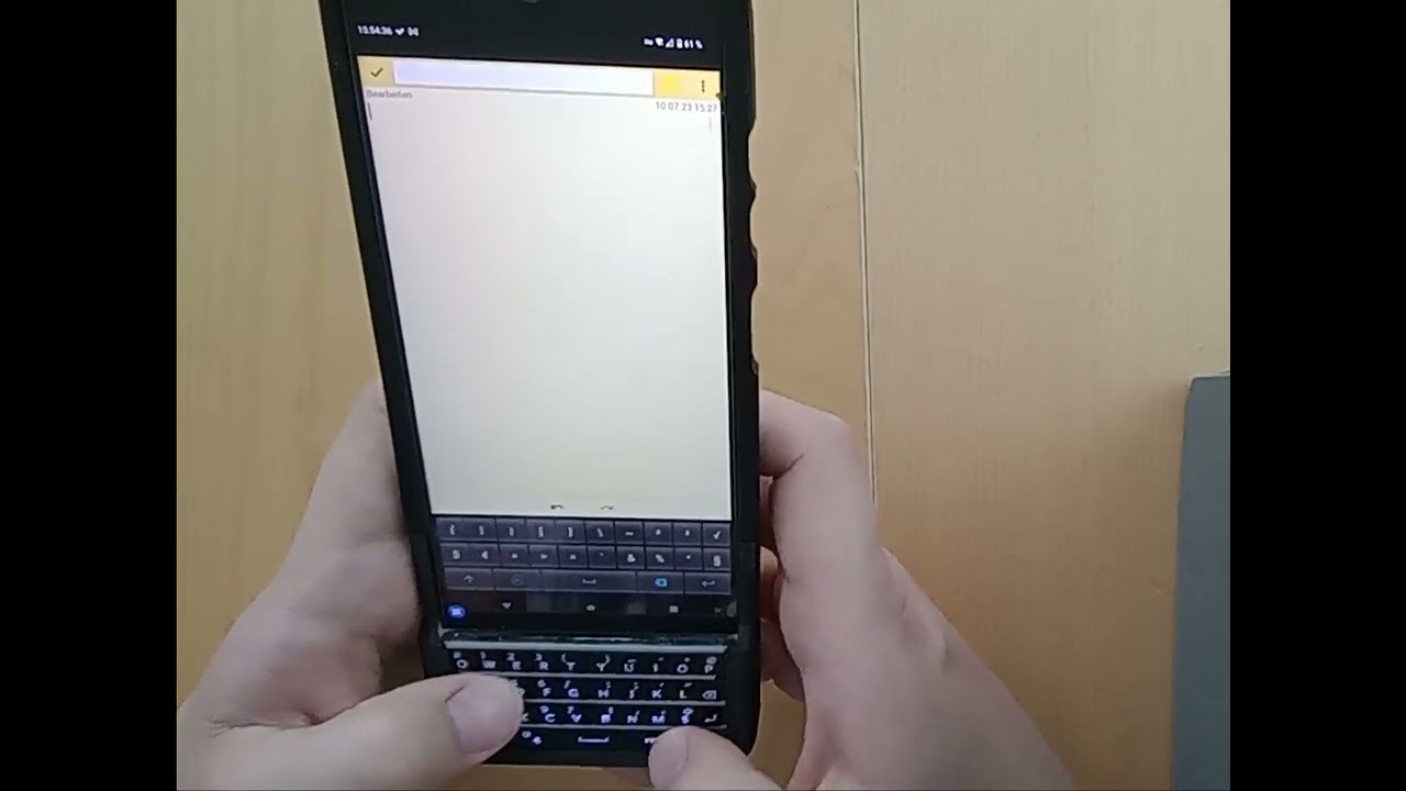

By the way, the prototype is working and open source under https://github.com/Dakkaron/Fairberry

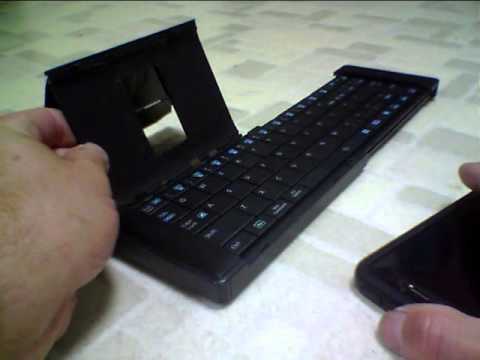

The best solution I’ve found so far is that Swype-like keyboard thing, which is surprisingly quick and accurate to input plain English, even when you’re shaken like a bag of popcorn on the bus or something. And the Swype-ish soft keyboard also has left and right keys - if not up and down. For anything else that requires more involved or faster typing and requires an attachment to the cellphone, I sit down an pull out one of these:
Your little device sits somewhere in the middle in terms of practicality for me: it makes the device too unwieldy for casual use and it doesn’t seem to provide fast enough input to make up for the extra heft.

Obviously, my creation isn’t for everyone as evidenced by me being the only one who (afaik) has one :wink:
But for me it’s small enough that I keep it on all the time.
Obviously, it can’t compete with a full keyboard where you can do 10 finger touch typing. But compared to a virtual keyboard it offers much more precision, no need to use autocomplete or any other hacks and it works in any setting (from typing regular text to programming or using a command line interface).
But the biggest benefit compared to e.g. the device you posted about is that it has no drawbacks over a virtual keyboard (apart maybe from when you want to type really quietly).
I had a small bluetooth keyboard with a clamp to mount the phone to it. I had it in my backpack for over a year and in total I used it maybe 5 times. Because fetching it from a backpack, mounting the phone to it, re-pairing Bluetooth because the connection doesn’t work anymore and then realizing that the keyboard is all but empty because it’s been so long since I last used/charged it was always so much of a hassle, that it was just more convenient than just using the touch keyboard.
The Fairberry just stays on my phone. I pull it out of the pocket and it’s just ready and works. No bluetooth, no battery. If I need to access USB, I just pull it off, and when I’m done, I just push it back on.
I write a lot on my phone, since I often just have small breaks when I have time to do something quick. For that, the Fairberry is great, because it’s just super convenient and upgrades my most convenient kind of typing.
