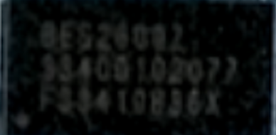

However, for the Fairbuds, the chipset in use appears to be from Bestechnic. The following zoomed still is from the teardown video of iFixit.
I read “BES260??” there which is most likely the rectangular shaped Bestechnic BES2600Z chip designed for TWS. The print on the chip is a match IMO.
It’s of course possible that Fairphone has switched to Airoha at some point since the release of the teardown video in April 2024. However, I doubt it.
