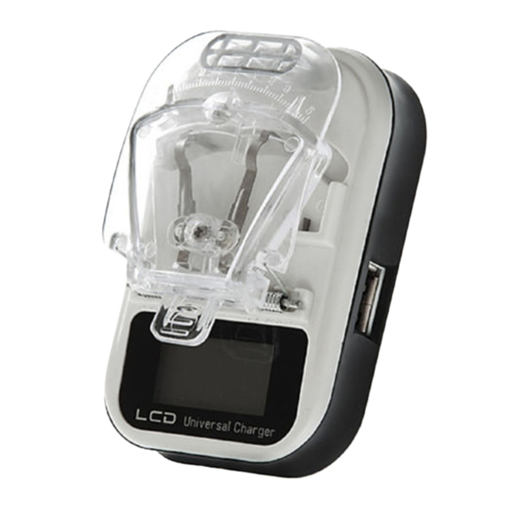

Two days later it stopped charging. I got a €6 ā€œLCD universal chargerā€ from a local shop and got the battery charged outside of the phone.
