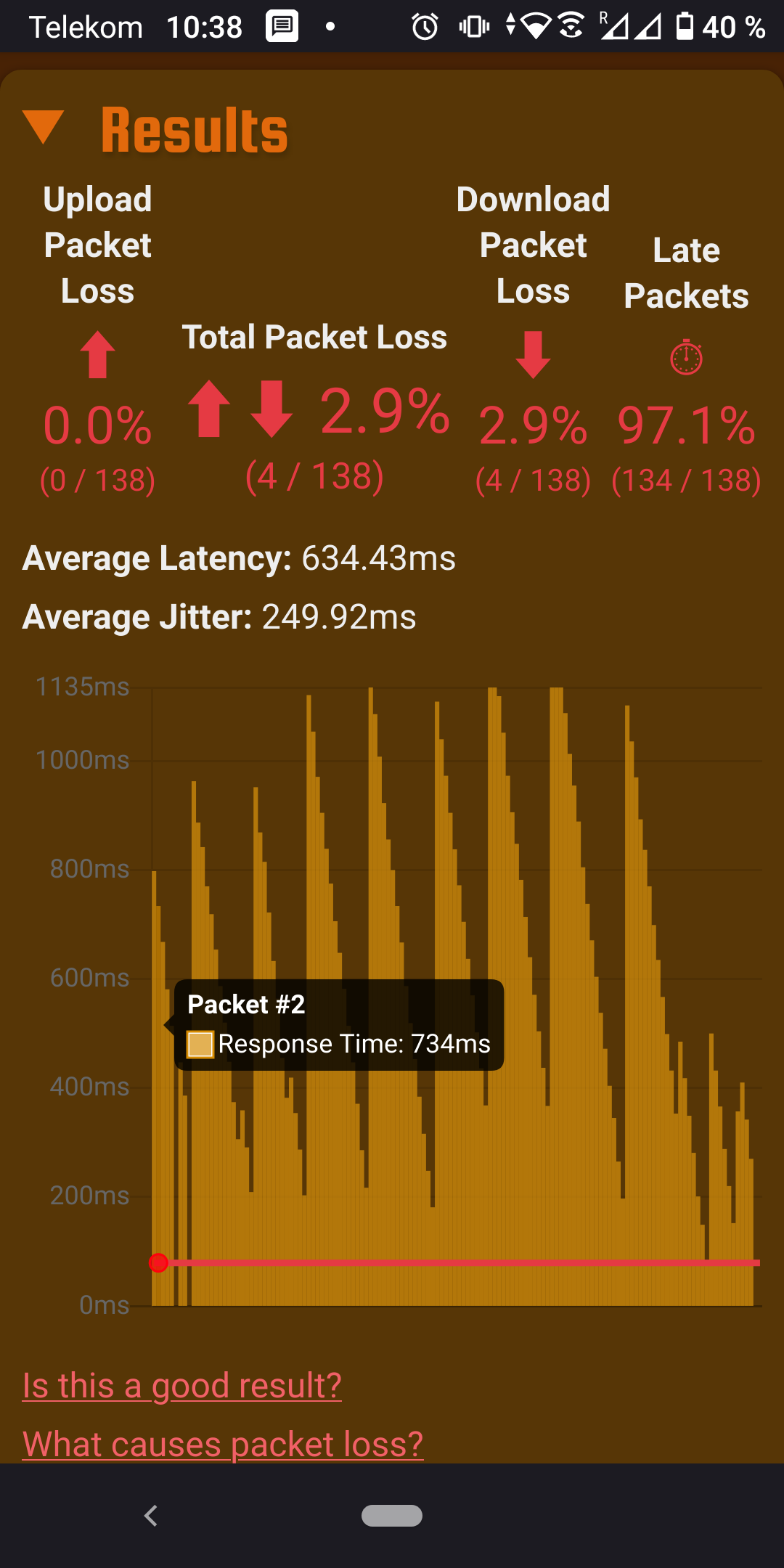

I found the website packetlosstest.com, which seems to be okay for my purposes (for the moment I’m in Texas, so the server being in Gerogia isn’t the hugest issue). I ran three tests on both my laptop and my phone, from the same location in my parents’ house.

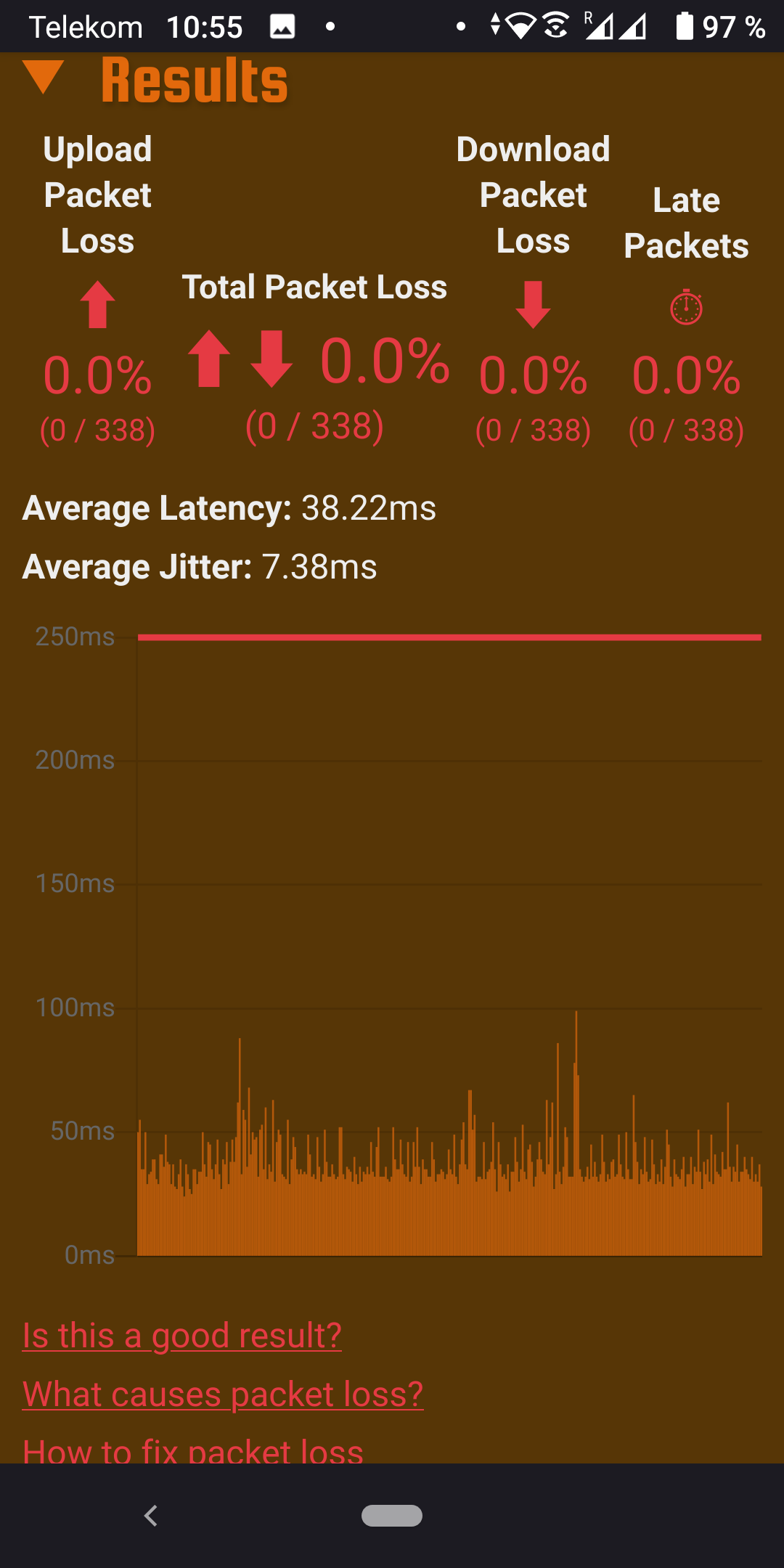

I have an update. It seems that the difference between my phone and laptop’s settings was the frequency band. I was on a 2.4GHz connection with my phone, and a 5GHz connection on my laptop. Changing my config settings to 5GHz immediately made the performance better on my phone.

Thanks for your reply! We’ve narrowed down the source of the issue further. My computer and phone both had bluetooth on during all of the previous tests so I ran three sets of two tests each on my phone: One without bluetooth and mobile data, one with bluetooth but without mobile data, and one with mobile data but no bluetooth. The connectivity measured was wifi, and in all of the tests that I’ve run, my phone was close to my computer with bluetooth activated.
Here are the results. From the filenames you may be able to see that only the test with Bluetooth experienced those issues. Looks like on a mobile device the interference is greater than on the laptop. Because now I’ve decided to set my phone to prefer 5GHz connection, I can say that the issue is gone and troubleshooted.
