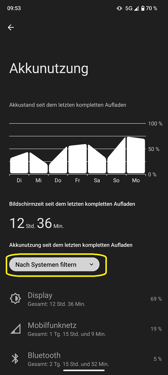

Maybe check Settings - Battery - Battery Usage and there you can check out the app’s power comsuption and also switch to system’s power consumption. Have a look if you find a suspicious (system-)app and compare the comsumptions between the two devices.
Views by systems says Screen 45%, Camera 44%, which is absurd as the phone was not used during the night, the screen was off and the camera was not used at all.

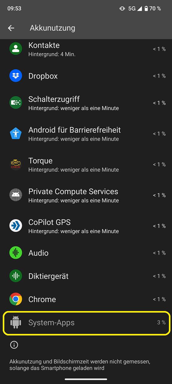

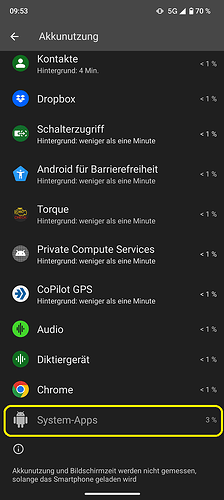

@mike_1312 as I never noticed that before: in the settings under battery consumption under apps there is a not saying anything point (for me at the bottom) called system apps…over night this morning it was at 25 (of the total power used, which was omly very few percentages in flight mode) its now at 5% as I use the phone.

@yvmuell that was not the point that I was talking about, but giving you a feedback for me, this point is always between 3% and 5% on my phone with my usage..
I’ve been talking about switching to detailed overview of power consumption of system apps here:
yes I know that you talked about the other view and that was just a comment as I never noticed that system apps thing at the bottom of all other apps mentioned in the initial post, and just wanted to mention it, in case other people neither noted this before.
