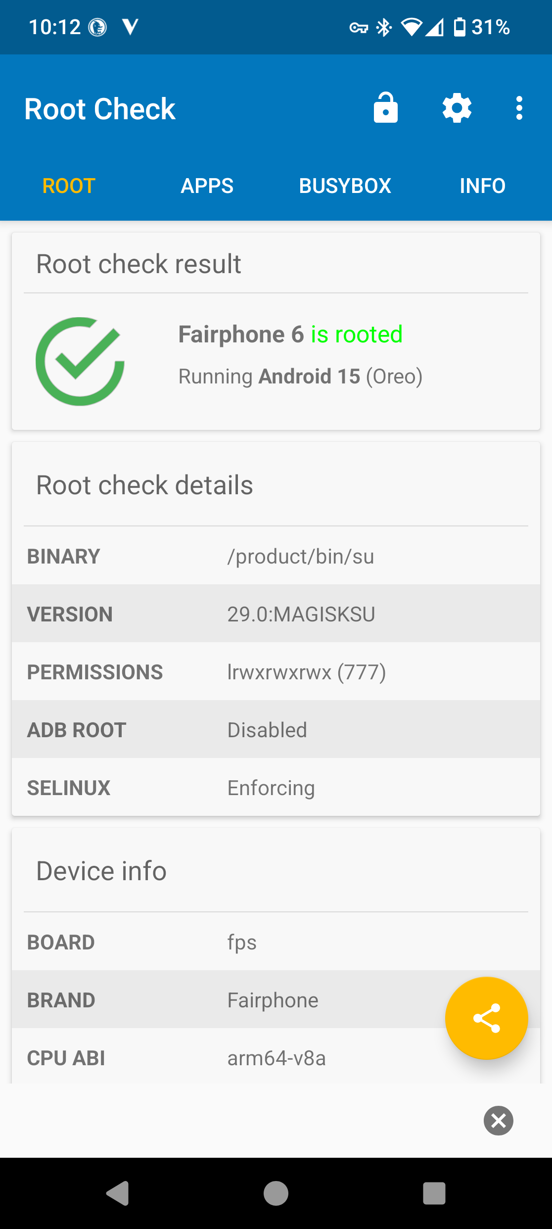

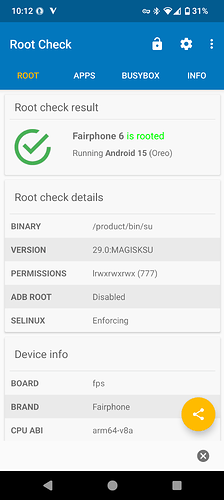

The interesting thing is I tried apatch first, it flashed the boot.img without any error.
Rebooted and checked aPatch app. It indicated “working”. Opened root check but no root. Flashed again using magisk app. Rebooted again and then I did get root. So not sure which tool actually did the trick. Both apps mention “installed” or “working”..:grimacing:
If you use apatch, you have to grant root permissions to your apps in the apatch app, there is not popup
I see, so it might have been Apatch that actually did the root but since I did not provide root checker superuser perms it indicated incorrectly that there was no root? So I should Patch again and the method you mentioned earlier to keep root after installating the new update?
Update: I think it was actually Magisk who rooted the phone:
Using Apatch and OTA
I think it doesn’t really matter which root method you use, depends on your preference
