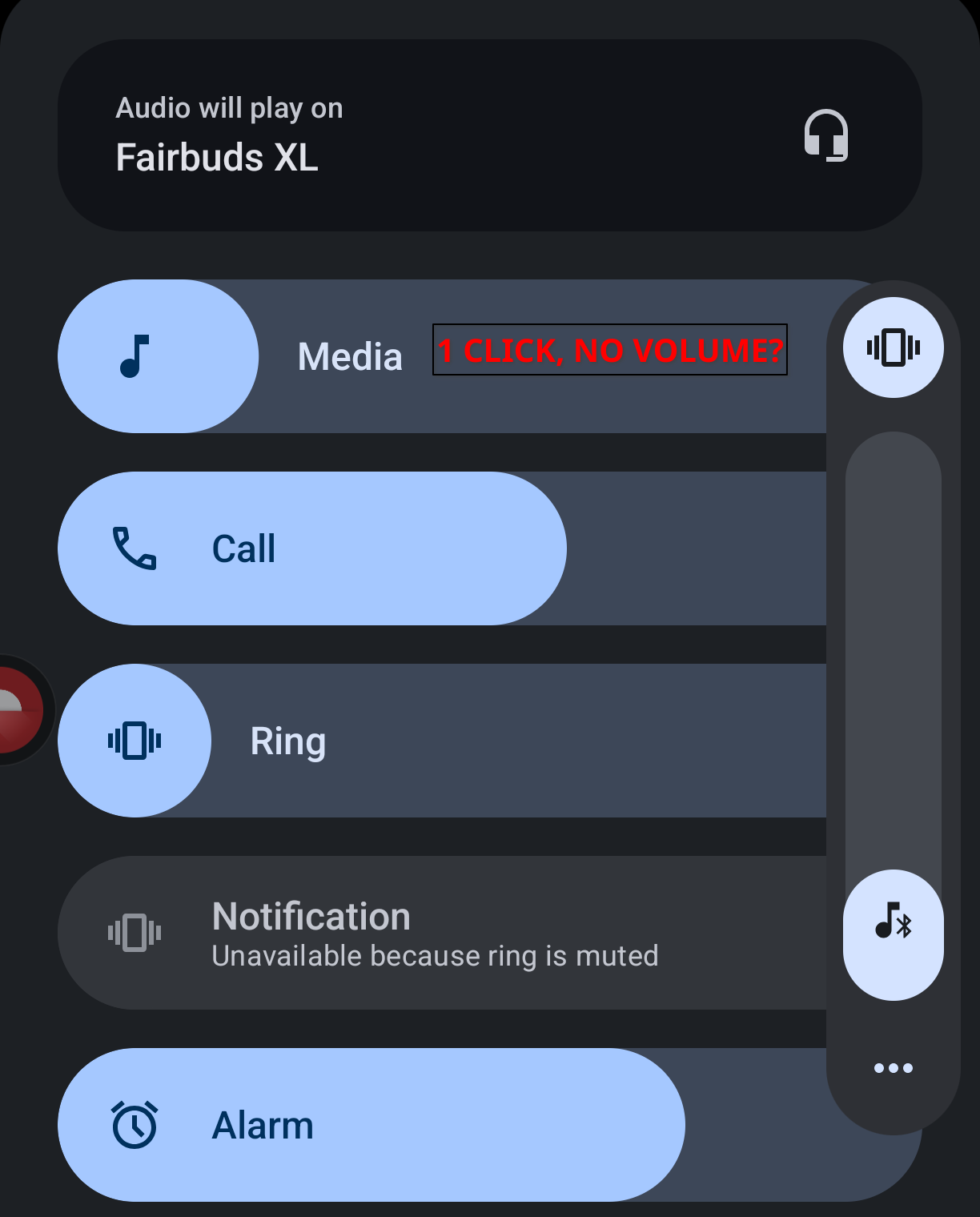

My Fairphone 5 seems to me increasing volume at 10% increments, not the usual 5%.
This is easily replicated by looking at the volume slider whilst clicking. If you turn the volume all the way down and increase the volume once (1 click) you still do not get any sound.
If you increase the volume once more (a total of 2 clicks) you start getting sound. I continues with this, only increasing sound every other click. This make finely adjusting the volume impossible.
