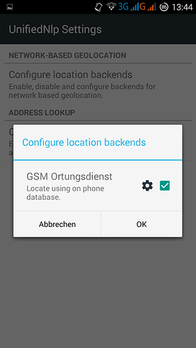

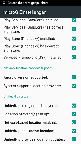

I’ve installed microG from their F-Droid repository.
I think I’m running microG successfully, but it still doesn’t work.

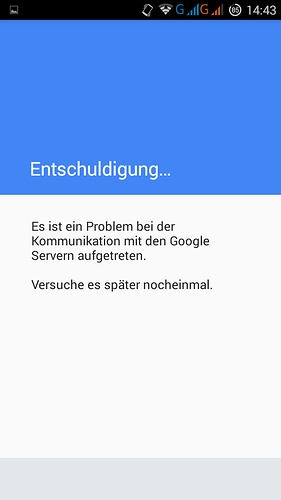

I tried to use Ingress to check if it is a problem with my settings, but when I’m starting it I have to use an account (I think google), but you see in the screenshots that I cannot choose it.
So I still think I have a problem with my setup.
