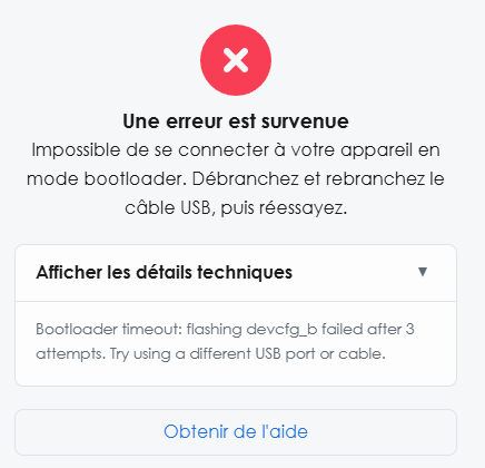

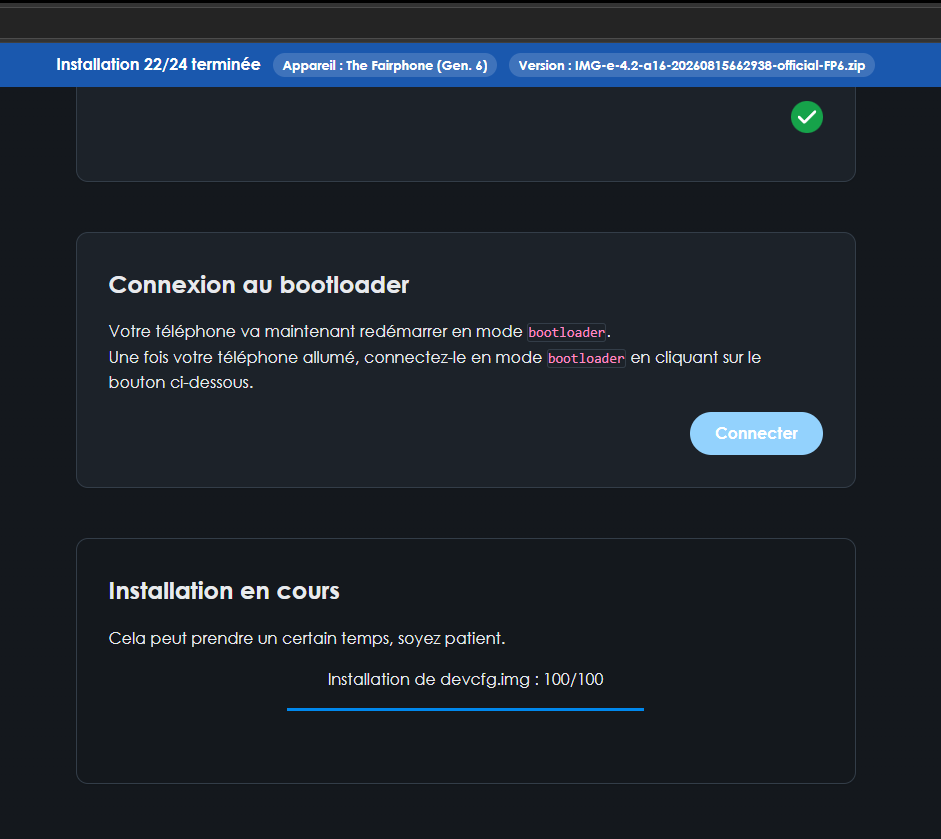

After that I tried using the e/OS website installer, everythings works fine till the e/OS installing step where I get stuck for a dozen minutes on a specific install, then I get this error
(Installing devcfg.img : 100/100)
(an error has occured : unable to connect to your device in bootloader mode. unplug and replub then try again)
