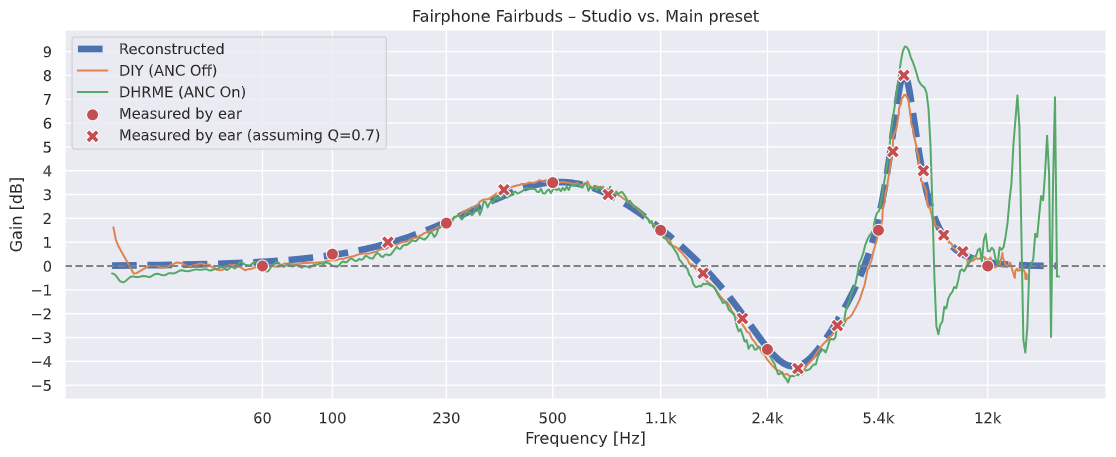

Does anyone, perchance, know the technical parameters of the Fairbuds (v67) EQ profiles (i.e. frequencies, Q-values, gain)? There is a noticeable change in the audio that I cannot match by ear, even when matching volume across all the frequencies.
It would really help me tune them. I already made great progress, but I cannot fine-tune it without the parameters, as the RTINGS frequency response curve – which I use as a base for optimising the parameters – uses the Main preset, where the built-in EQ cannot be tuned.
This is my best guess so far. Note that this is a visualisation of how to return to Main from Studio (since this is the only way to measure by ear and it’s more useful as a sound signature in AutoEq), so the Studio preset itself is inverted.
Parameters:
Frequency [Hz] Gain [dB] Q
550 3.7 0.5
2900 -5 1
6500 9 3
