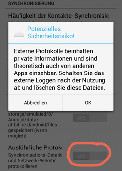

:de: In den Einstellungen zu einem Account kannst du ein Fehlerprotokoll auf die SD-Karte speichern lassen:
:gb: You can log to SD card in the settings of an account:
@DjDas @Stefan
unfortunately I cannot switch on the protocol. When I try to move the switch to AN I get a warning, and when I click OK the warning is repeated again and again but nothing else.
For logcat you simply need adb or an app like OsMonitor in order to get the system log messages and then you can copy/paste them in a text file.

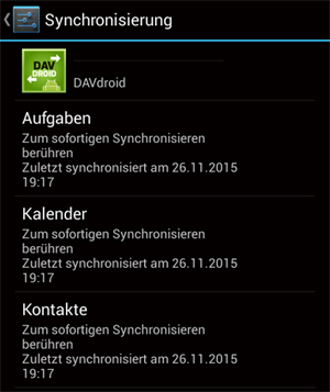

It is a bit weird, because apparently as I have tried out a few times now, the tasks ARE synced between FP1 (via posteo) and thunderbird in both directions.
Only the syncocol - as in the screenshot I posted before - says that the last sync is from Nov 18 and that there are problems.

Update:
without me having done anything everything is alright again now (look at syncocol):
Davdroid: it’s magic :sunglasses: - champagne for all!
