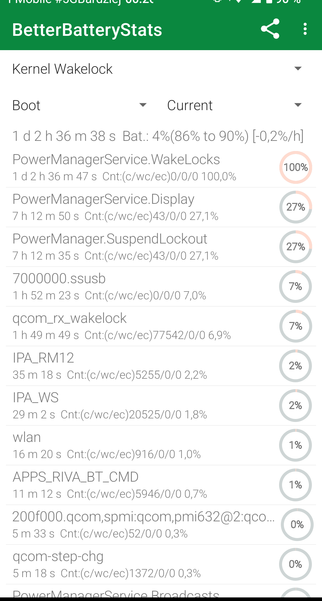

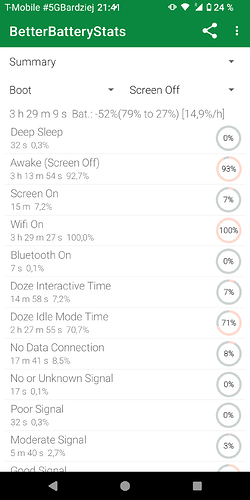

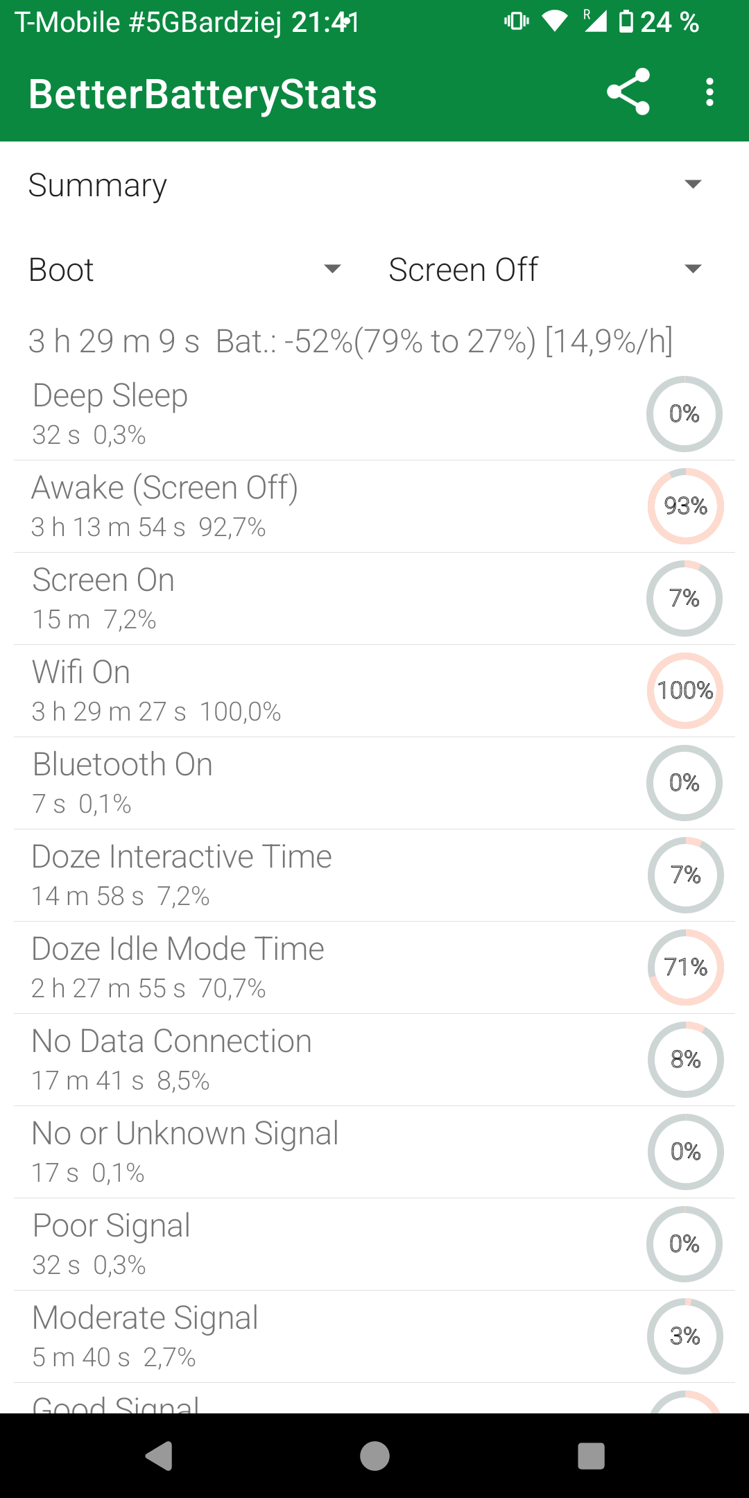

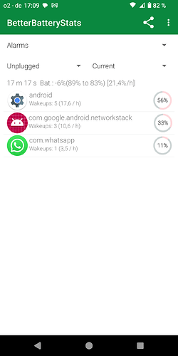

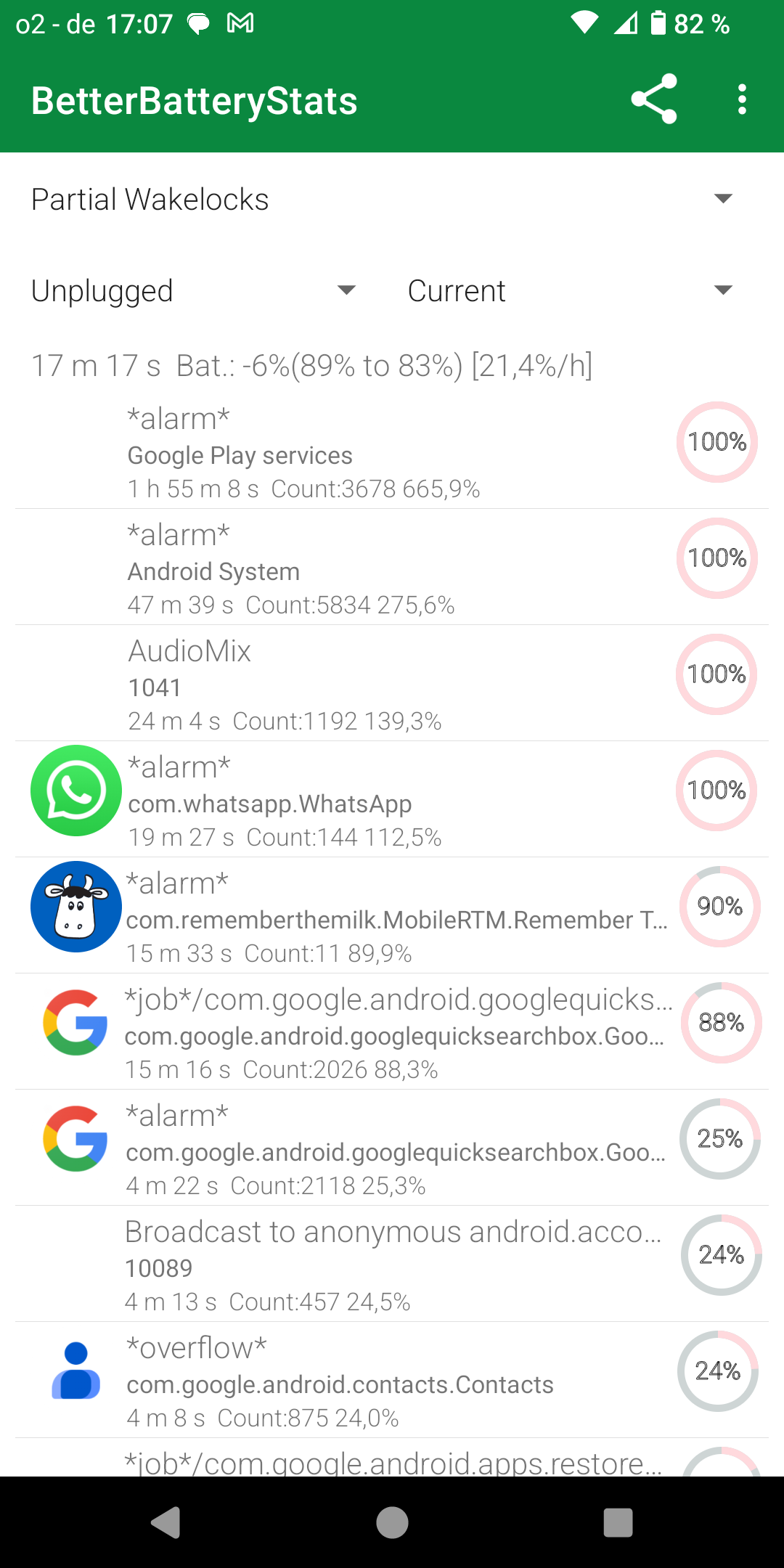

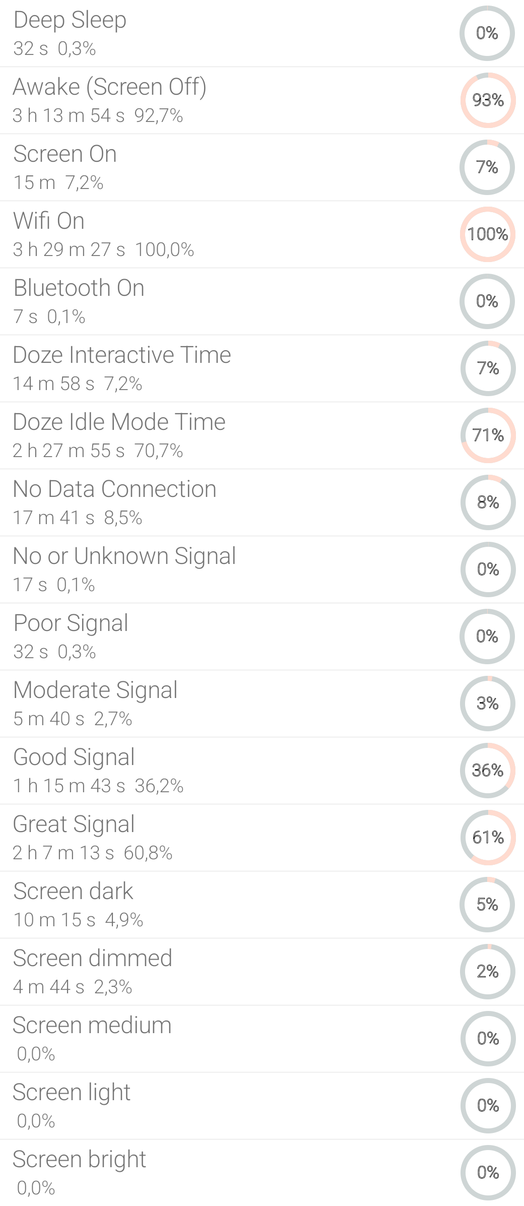

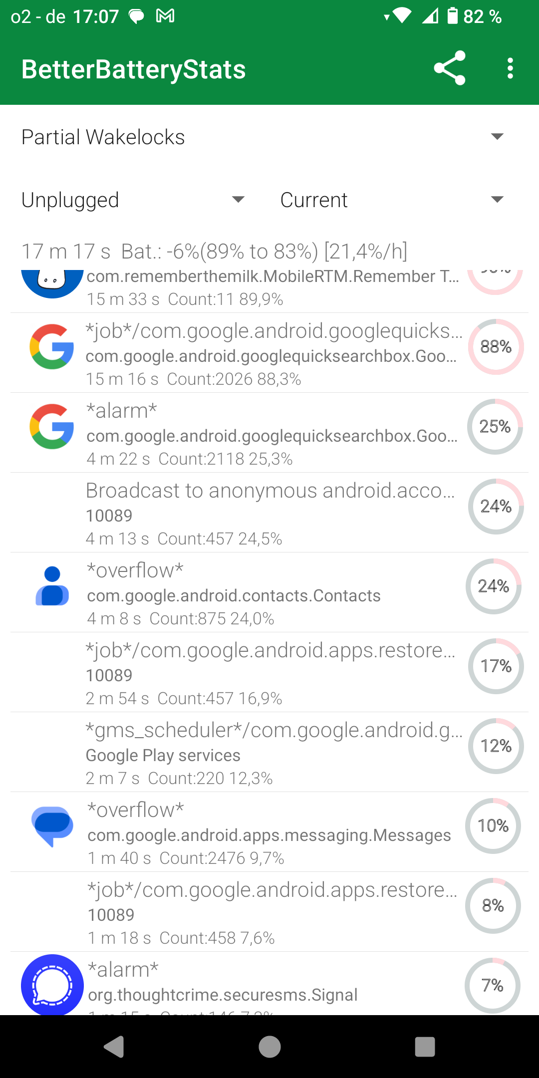

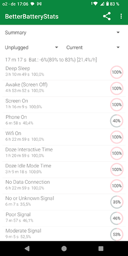

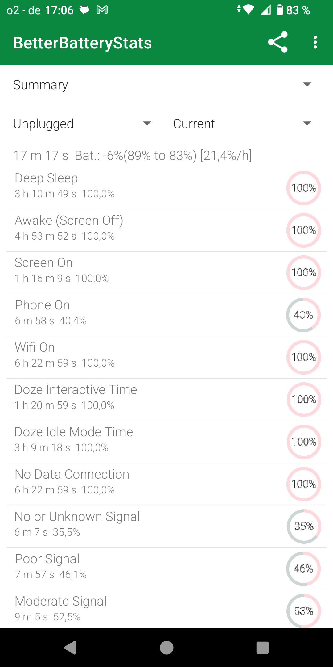

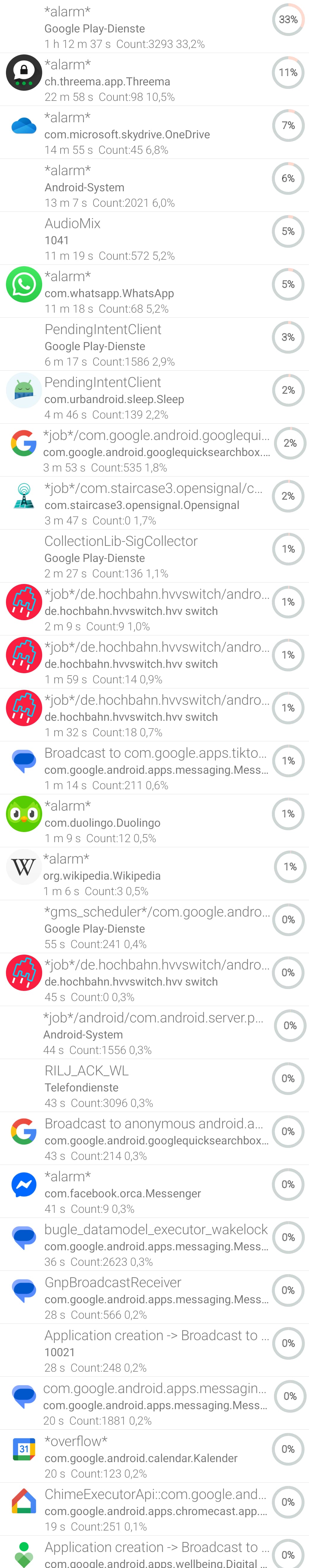

So after a while I managed to get Better Battery Stats running with ADB, with the help of that article you sent and the official documentation (some permissions have to be granted):
https://better.asksven.io/betterbatterystats/non-root/

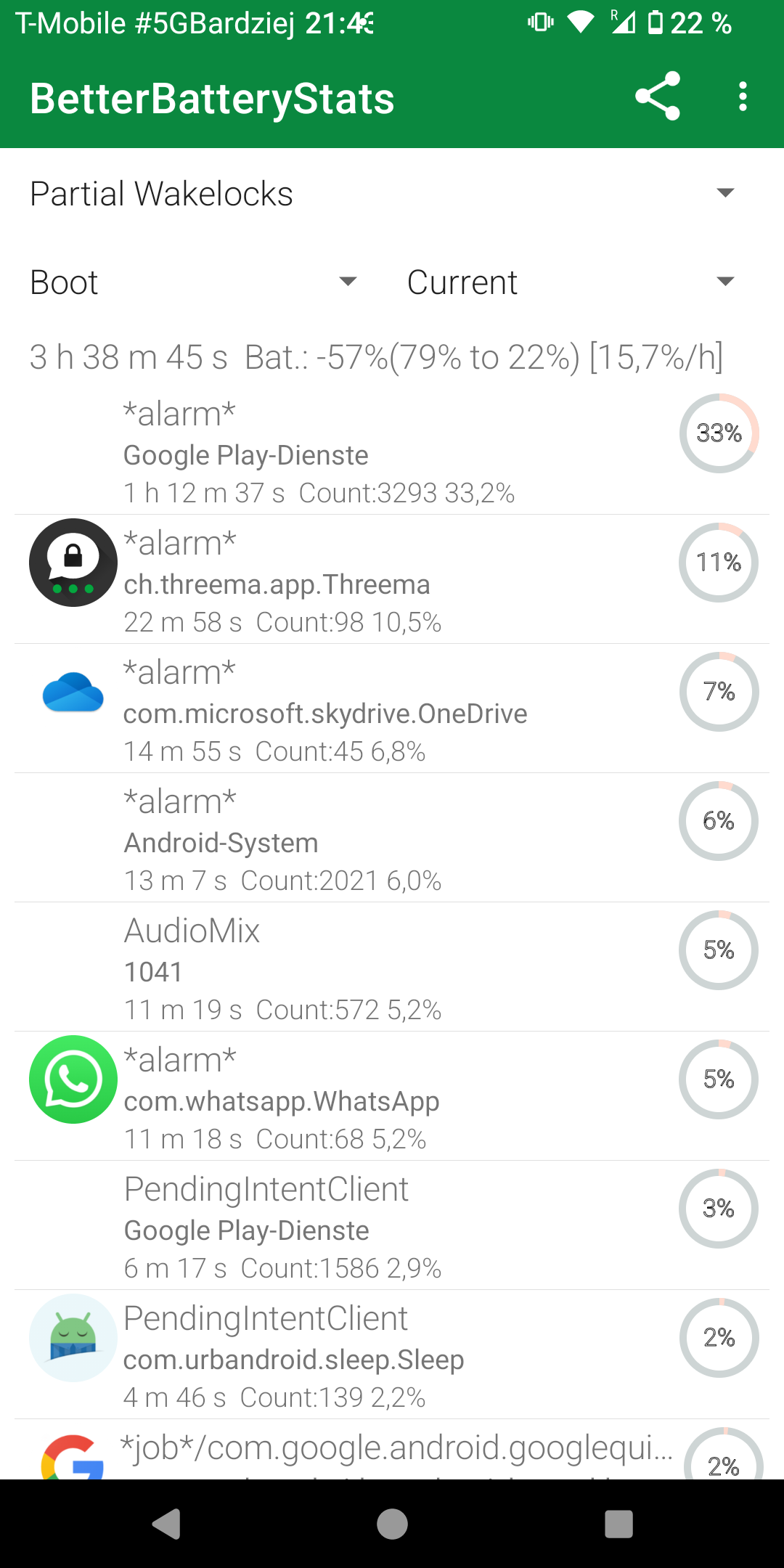

Now I got the stats but am not very sure about what to do with them (see screenshots).
Am I seeing right that Google Play services, Android System and AudioMix are sending many alarms and thus preventing the phone from getting into Deep Sleep?
How can I proceed from here?
Thank you

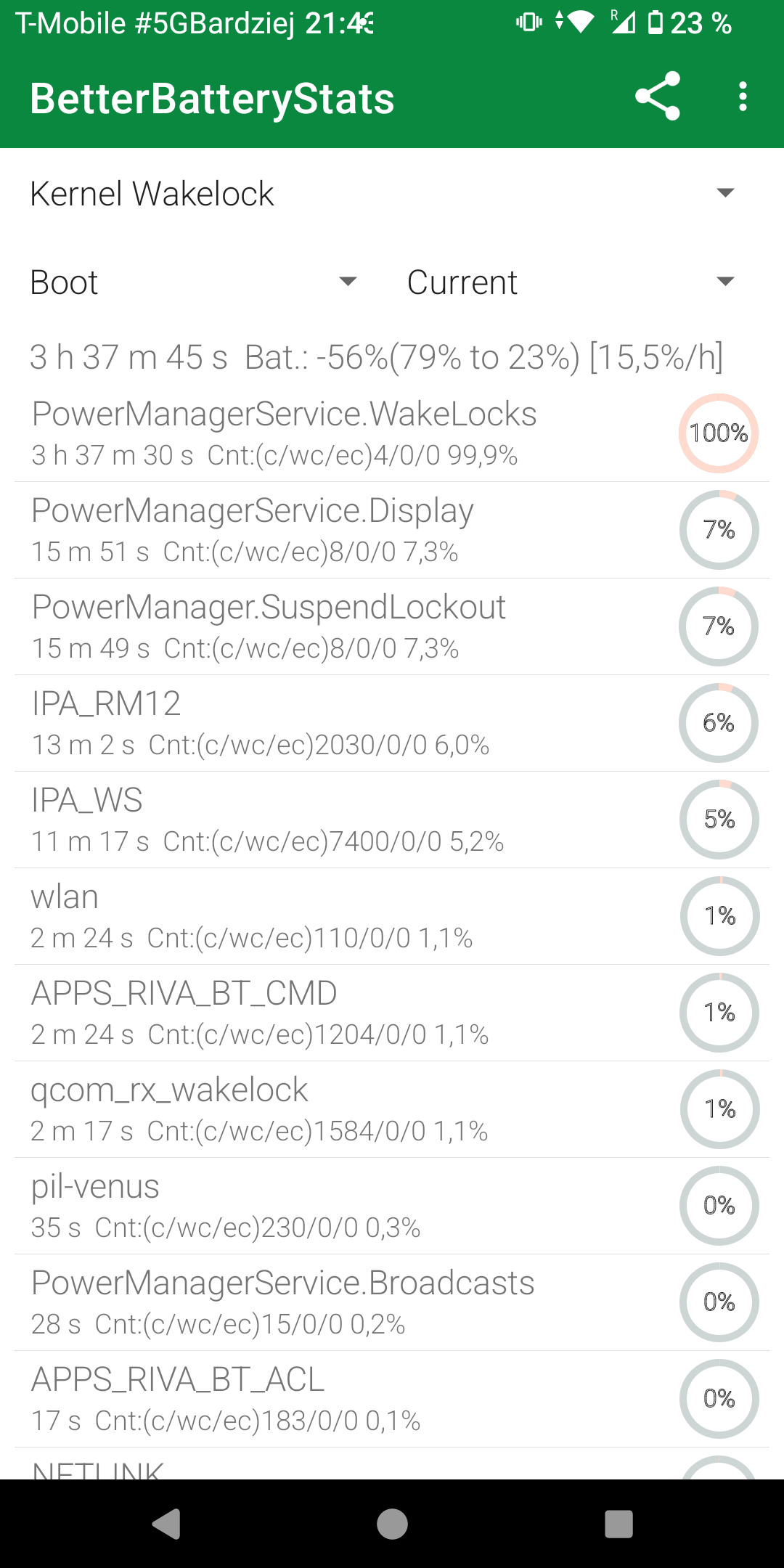

I would say, I would start with the kernel wakelocks, but from what I see from the summary the phone was in deep sleep for about 75% of the time. What about the processes?
Searching the internet for qcom_rx_wakelock, 70000.ssusb (see for example https://xdaforums.com/t/workaround-for-70000-ssusb-wakelock-power-drain.3824441/) and the 2 IPA_* wakelocks shows, that those seem to have caused battery drain for others.
Some more hints:
  • I had something similar in the past with play services and removing the storage and cache of that and restart the phone helped a bit.
  • You could try something like EnforceDoze | F-Droid - Free and Open Source Android App Repository in order to get into the least power consuming mode of the phone

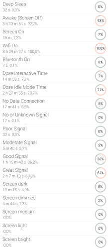

  • You could try to check the CPU status and see in which states and more important frequencies the cores are running.

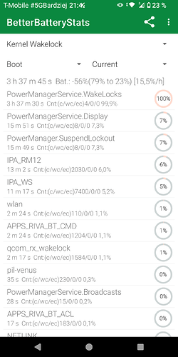

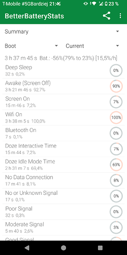

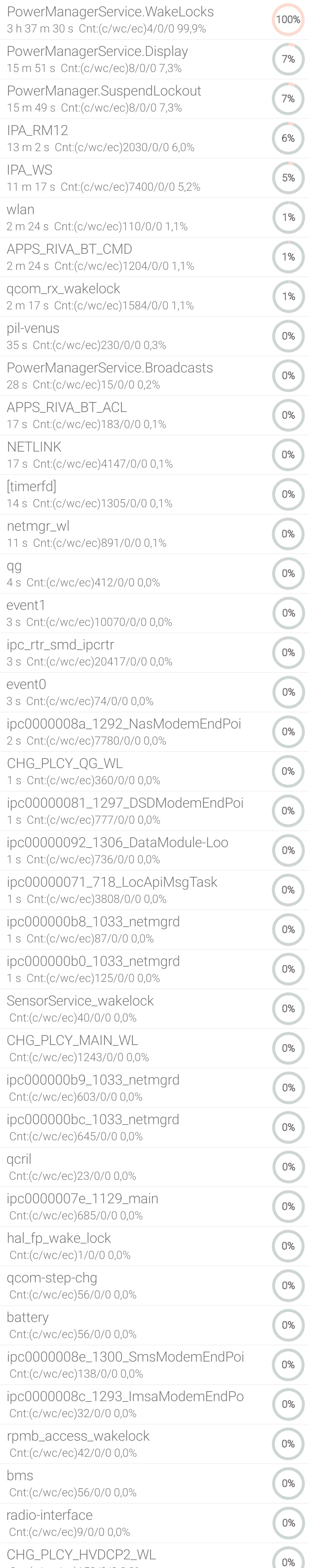

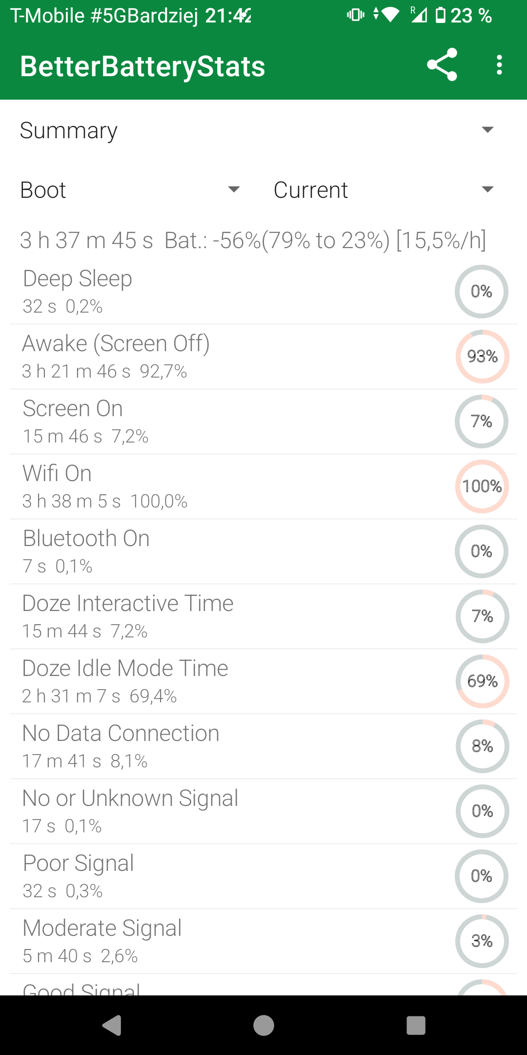

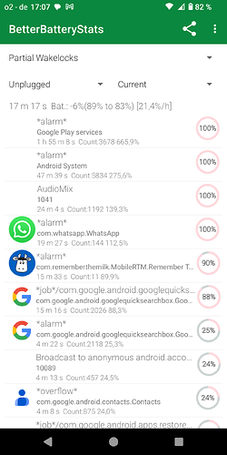

How to track down what’s causing the 100% Powermanagerservice.Wakelocks?

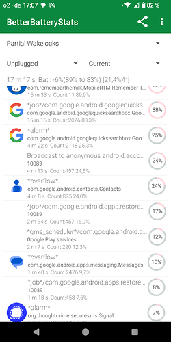

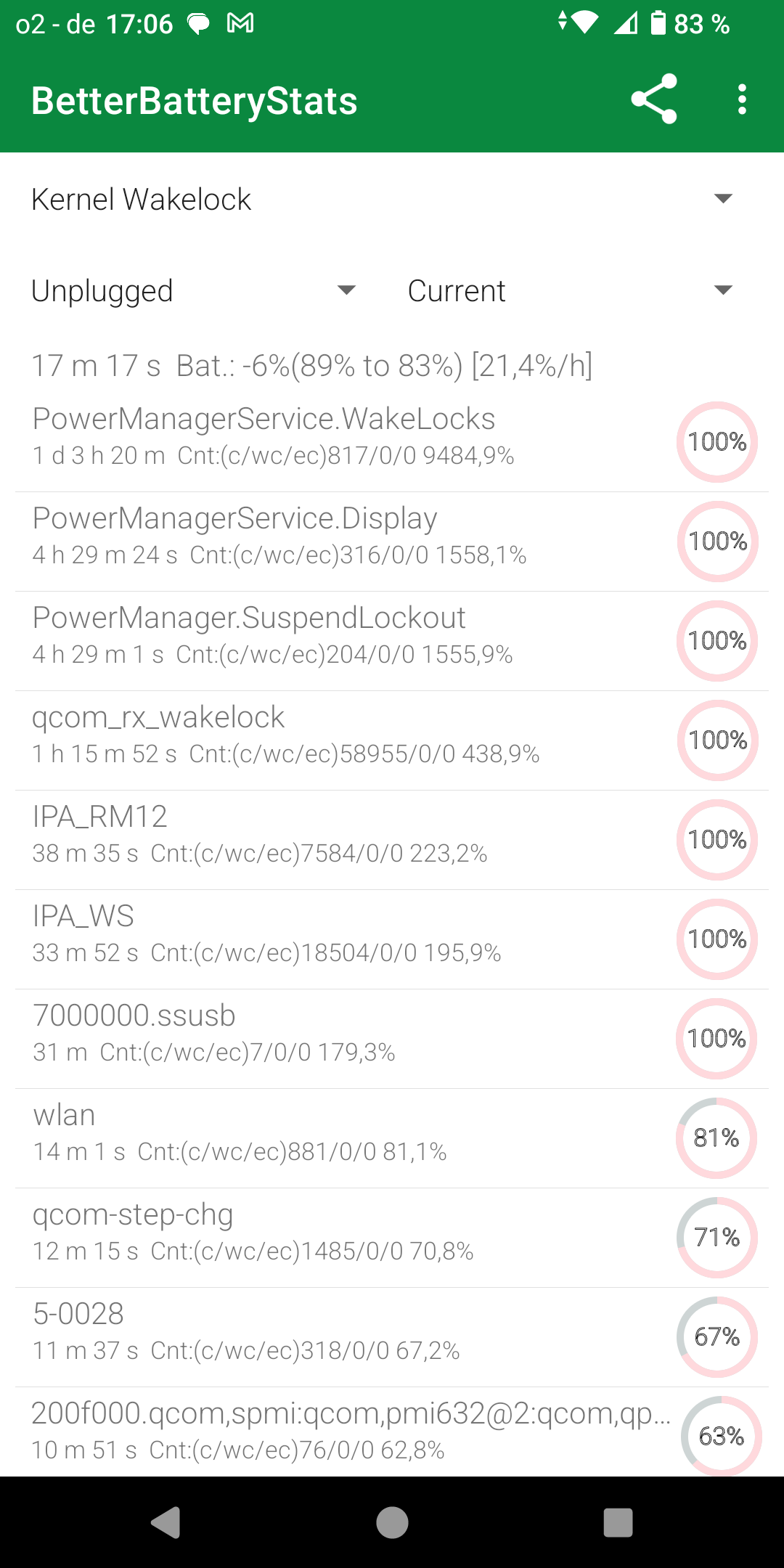

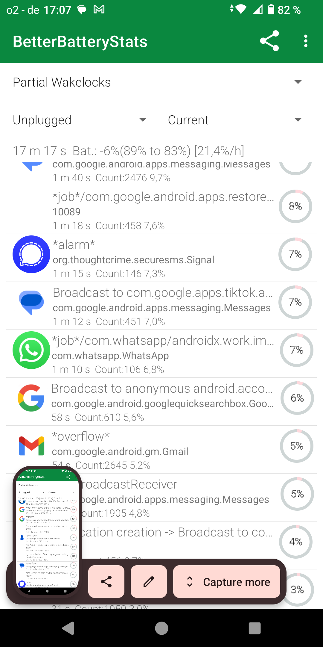

Same issue with my FP3, replaced the battery but that didn’t solve it. Started about 2 weeks ago.
Unlike oriolgilis phone, mine is at 0% DeepSleep and 100% Powermanagerservice.wakelocks
Any suggestions how to proceed?
I tried using EnforceDoze, but this didn’t make a difference.
Here are some current screenshots.
My phone apparently went back to normal (~2-3%/h battery drain) after removing the storage and cache of Google play services.
Now it’s been OK for the last two days, I’ll keep an eye on the power usage for a while still but it looks better now.
Thanks for the support
