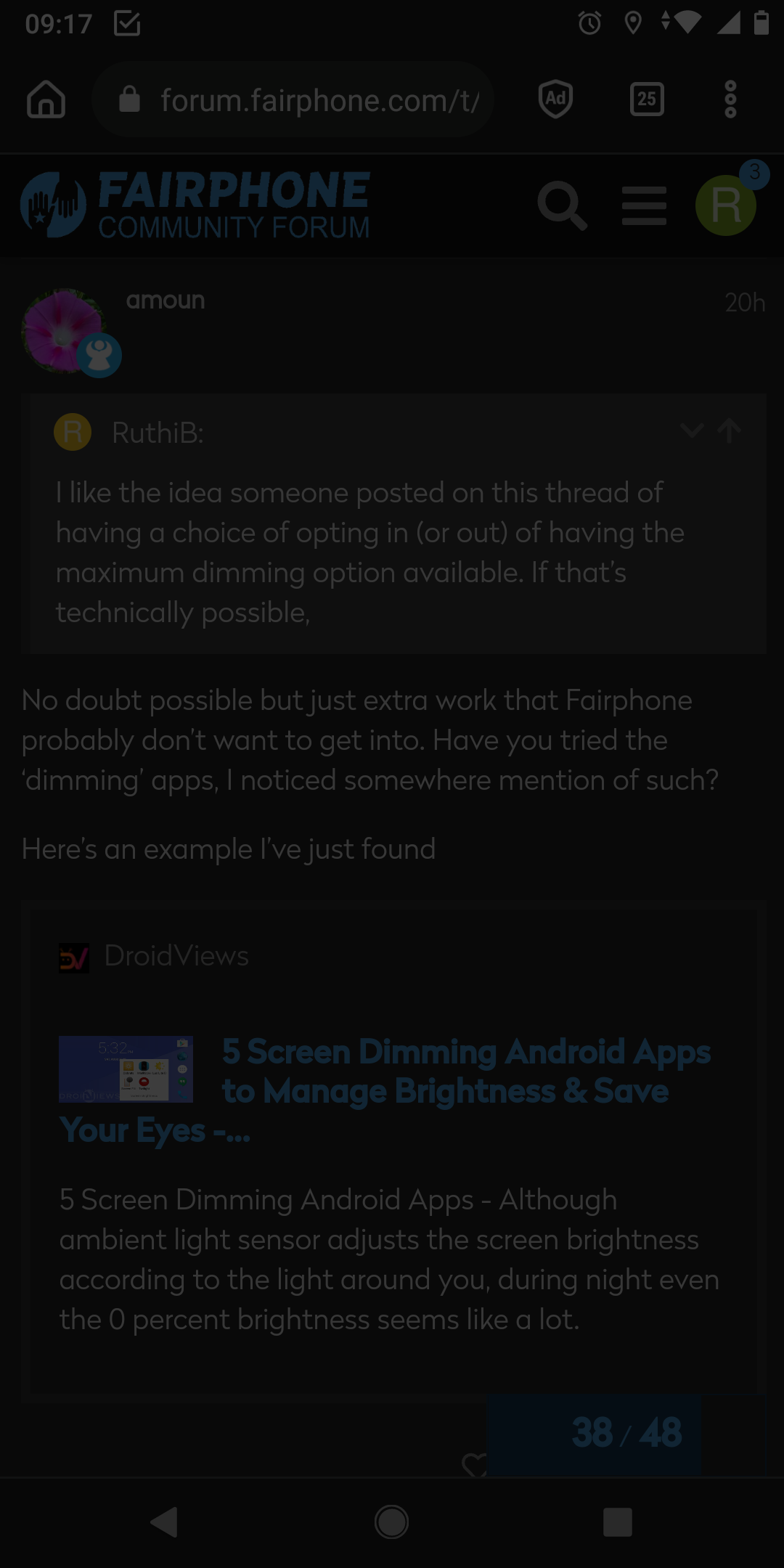

Since you are bringing up screen dimming apps again, I’ll demonstrate to you now one of the major problems (screenshots):
One with and one without screen dimmer. The screen is not really more dim, it’s just a gray overlay. It dims the brightness somewhat, but also makes it harder to read on the phone, because everything just becomes, well, gray.
Also, for the screen dimmer to work, you have to essentially give permissions to everything including reading everything you type (passwords) and full access to your phone. I don’t want that and others don’t want that too, for obvious reasons.
Please don’t mention screen dimmer apps as a solution for the brightbess problem. They are a work around, but a very crude and annoying one.

However putting a grey filter on is like wearing tinted sunglasses, and as long as it not a coloured one then I would imagine all the pixels that are ‘lit’ will just be dimmer, which is what pretty much happens when the brightness is lowered,
Which come back to the permissions issue. I’ll try one and see how I get along. Which one did you try?
The screen shot you show is really dim, maybe at that level you would have to increase the brightness a bit, but then a screenshot on a PC in daylight isn’t very ‘real’
As for not mentioning screen dimmer apps ~ given there are a few people who complain about the issue, and that this is a user forum, it seems only reasonable to offer such ‘work arounds’ which may at least suit some people of at least make the phone easier to use in the dark for those with sensitive eyes.
I’ve just installed ‘Dimmer’ from the F-Droid repository, will let you know how it works ~ tonight.
Well I’ve just tried it in the day, it works in some senses, in that it works. The app is 7 years old and I didn’t get the scale to work, but it’s dark allright I could just about see to opperate.
